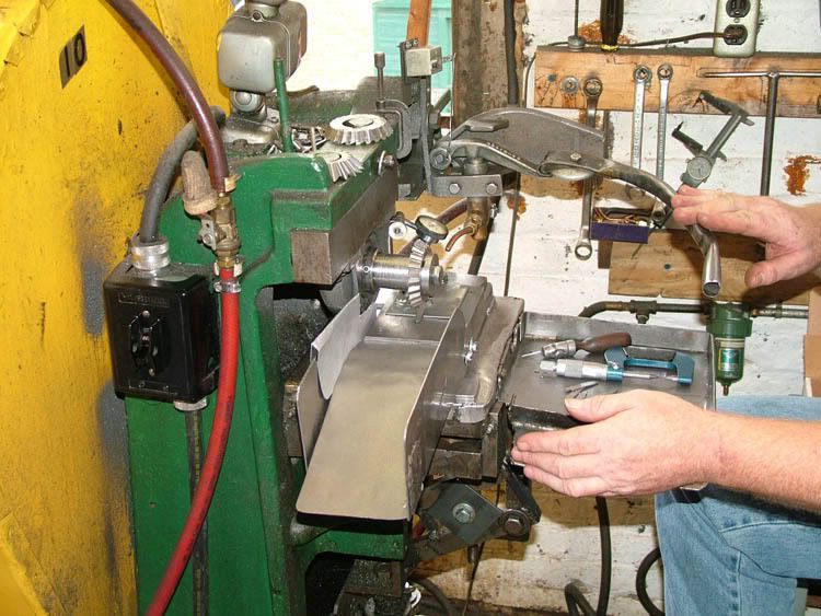

I do have an older logan 10" swing lathe....which would take any size shaft if I put the shaft in the chuck. I wonder if I could figure out a setup to hold the blade vertically and move it into a larger flycutter or the saw type you described above.
Here are a few terrible pics i found with the idea:
This one not a lathe but same concept, blade under cutter:
These two look like a lathe setup (horrid quality)

You could definitely make the lathe setup work by fixturing the blade in the tool holder. The downside is that you lose 1 axis of movement compared to the mill, which might make positioning pretty difficult.
