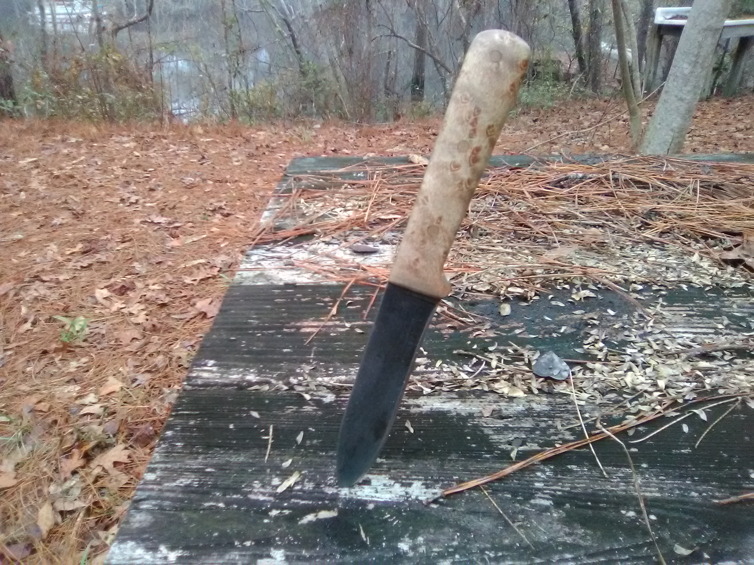

I find the Condor Kephart too small, but not the Becker Kephart which is ~5". Sabre.... think of a calvary sword blade shape.... The Bushlore blade shape is very popular and you will see it on many handmade knives. I have two Condor Bushlores (original and current model). I use the original with its thicker bar steel as a hard use work knife that I cut potentially very abrasive things with it. I also use it for digging weeds in my yard. I generally like a 5-5.5" fixed blade for woods carry or general purpose woods use. That is not a chopping size, but you can baton with it quite effectively if you want to. I prefer something smaller for hunting chores, but I haven't hunted in a couple years.
Mora is a pretty universal pattern along with puukos in general. Most general knife patterns like those will work. My only advice is to keep the handle beefy. A big comfy handle is really nice on a woods knife.
