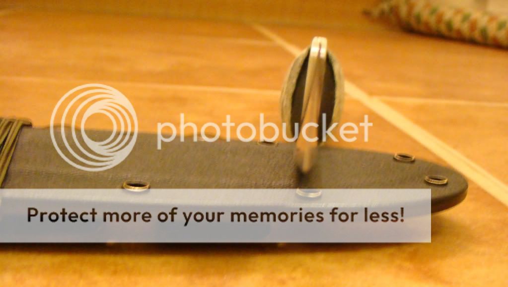

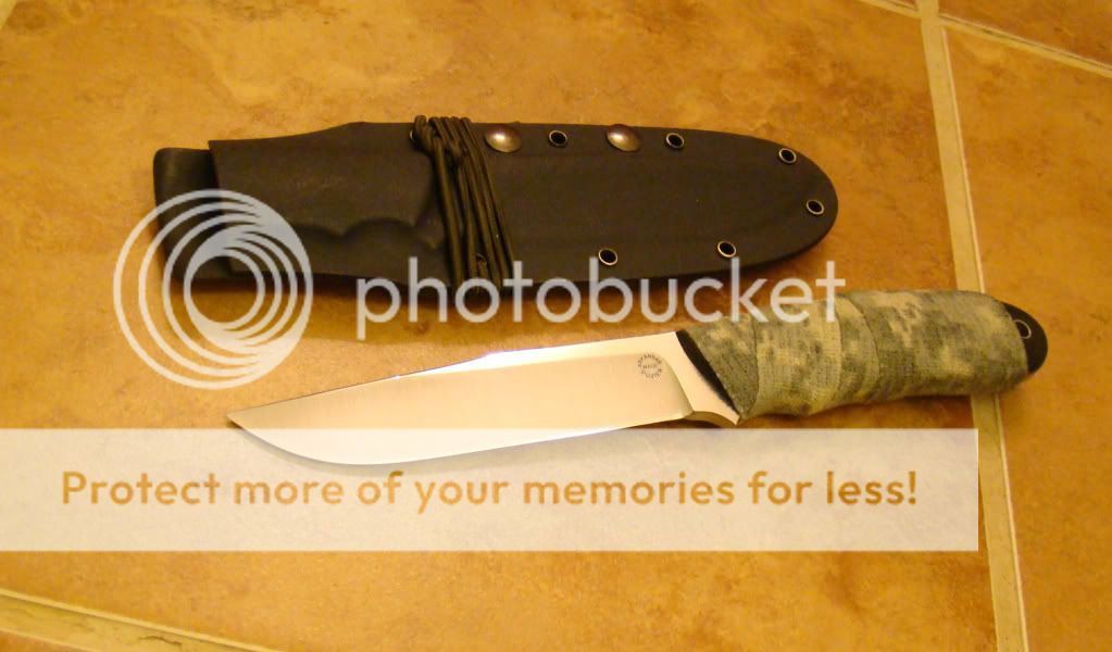

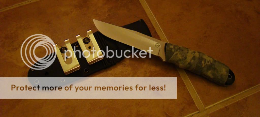

You are very right. My highly recommended not to use waterstone on Dozier as the hollow grind is very high hollow grind which is very hard to sharpen on a whetstone. I almost ruined the edge. I had to use spyderco sharpmaker to restore it. After that, Leather strop to give the blade a mirror edge. Now, Dozier keeps the knife a rough finish that is the main possible cause for blades to have rust in humid places. I used 600, 1000 and finally 2000 to smooth the entire blade and green compound polishing to have that soft smooth feel. My other D2 never rusted like from Benchmade especially one with stone washed.
So, never sharpen a Dozier or any other blade with high Hollow grind on a benchstone. Use light touch up on sharpmaker. Spyderco ceramics can eat away the Dr edge easily so be gentle.
