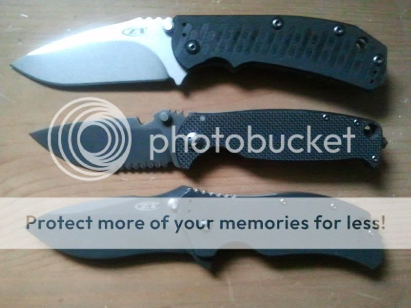

I have a ZT 0550 and Hest T3, as well as a ZT 0350.
All three are really capable blades. I did a little comparison post a couple of days ago, which sort of went unnoticed. Maybe it will help you:
http://www.bladeforums.com/forums/s...e-comparison-ZT-0350-0550-DPX-T3-amp-Native-5
While I prefer the Hest for its proportions, size and wear comfort, I really love the 0550 for its superior finish and quality. This is not to say the Hest is not as high quality, I just feel ZT goes the extra mile and finishes their knives to the nth degree. All edges are rounded off, all seems are perfect. No rough areas and the blade is just so exquisite.
Anyway, these are just my opinions, your mileage may vary...
