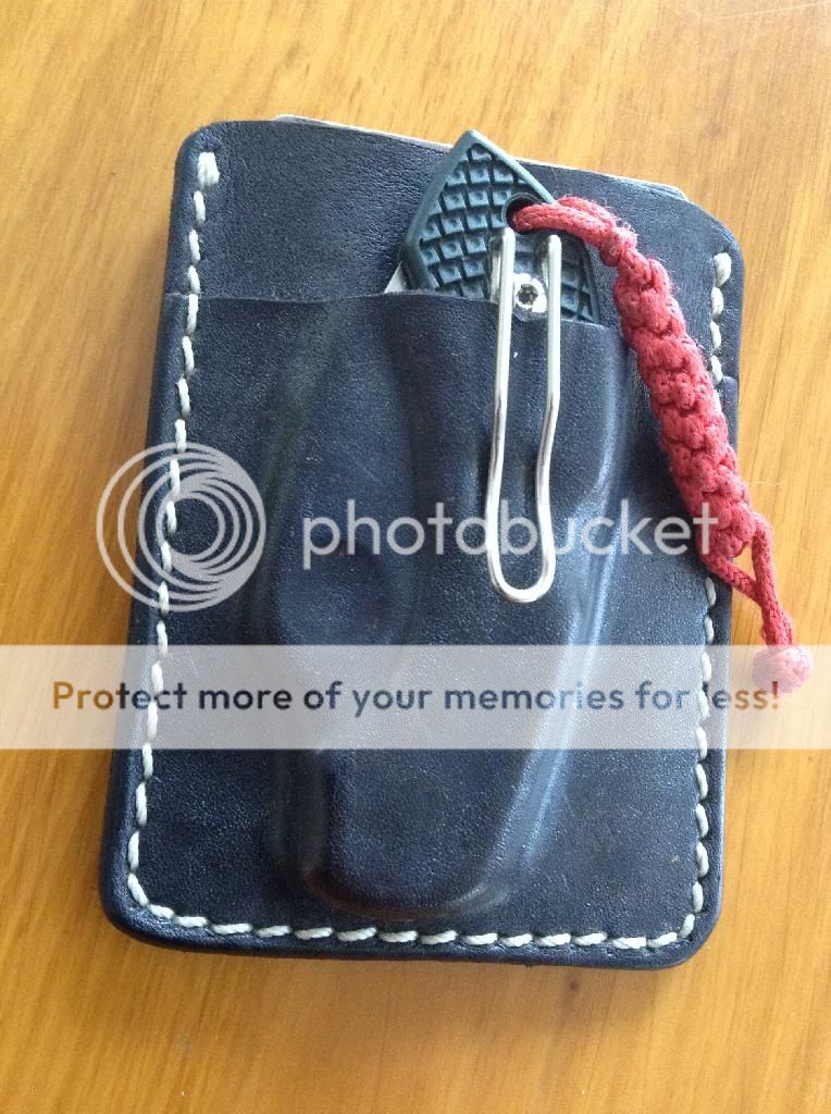

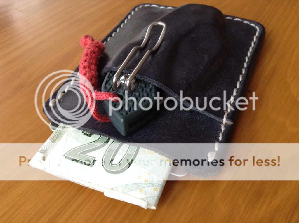

Hey there just thought id share some pics .
Ive been useing my dragonfly so much i decided to make a
Dedicated wallet .
With my own humble crafting skills i came up with this from thin leather .
Used vinagaroon dye ( really like vinagaroon its awesom !) .
Anyways its super slim just for the dragonfly and a few folded bills ....
Hope you like !

The wallet is a little worn in and dirty in the pic .
Yeah just left some steel wool in a jar for a week .
Its actually a really dark black and very even .. Really easy method . Also it wont transfer to anything else .
Made some friction sheaths with it too , i really like it .
Smells pretty bad the first couple of days , i used my own beeswax olive oil cream to buff it and seal it . That helps get rid of smell too .
Edges are rubbed with straight beeswax and burnished .
