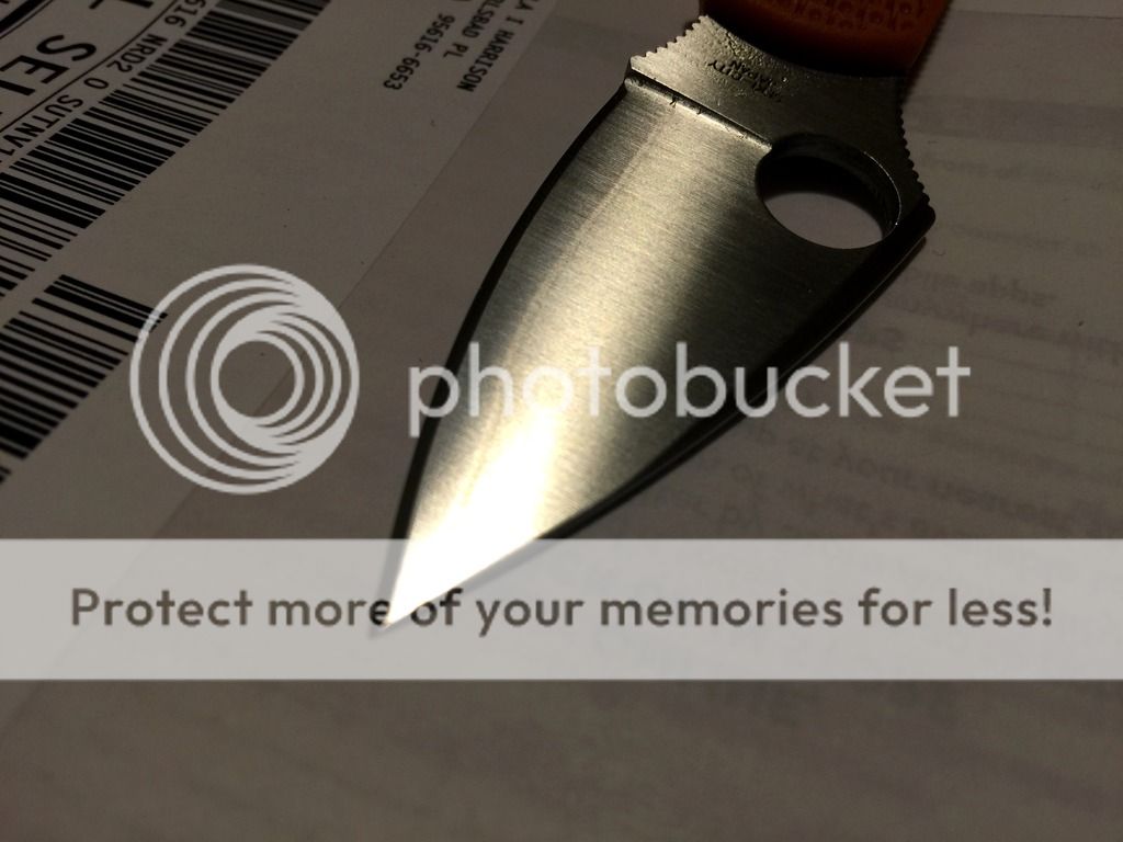

Can someone tell me what these lines on the blade are? They don't seem to be scratches and won't come off.
Just received this from a reputable seller as new as brand new.

To answer your questions those are lamination lines. The blade is made of HAP40 sandwiched between a softer stainless steel (SUS410), and the lines show the boundaries between the layers.
The Hap40 is sandwiched between the SUS..
Then when they flat grind the bar stock, it makes those lines.
It's the edge of the SUS..
The SUS is more corrosion resistant then the Hap..
You paid a lot of extra money for that line on the blade , don't try and rub it off :)
Welcome to Spyderco , the DF2 is a great knife .
Ken
Welcome Skyler, the line is perfectly normal. The hap40 steel that's at the edge is some of the best knife steel used today. We don't use words like "best" much around here when describing steels because so much of that depends on what you are looking to for in a steel and what type of work you are doing. I will break precedent for hap40 though. Its good stuff. Be happy that you accidentally got one of the dragonflies with "the line" before they all disappeared.

Don't sweat it Skyler!! Totally normal.......and PLEASE don't try and remove them bro!!! You aren't a noob anymore.....you are now officially a newb!! A much more pleasant moniker!!

All of them have it, totally normal.
