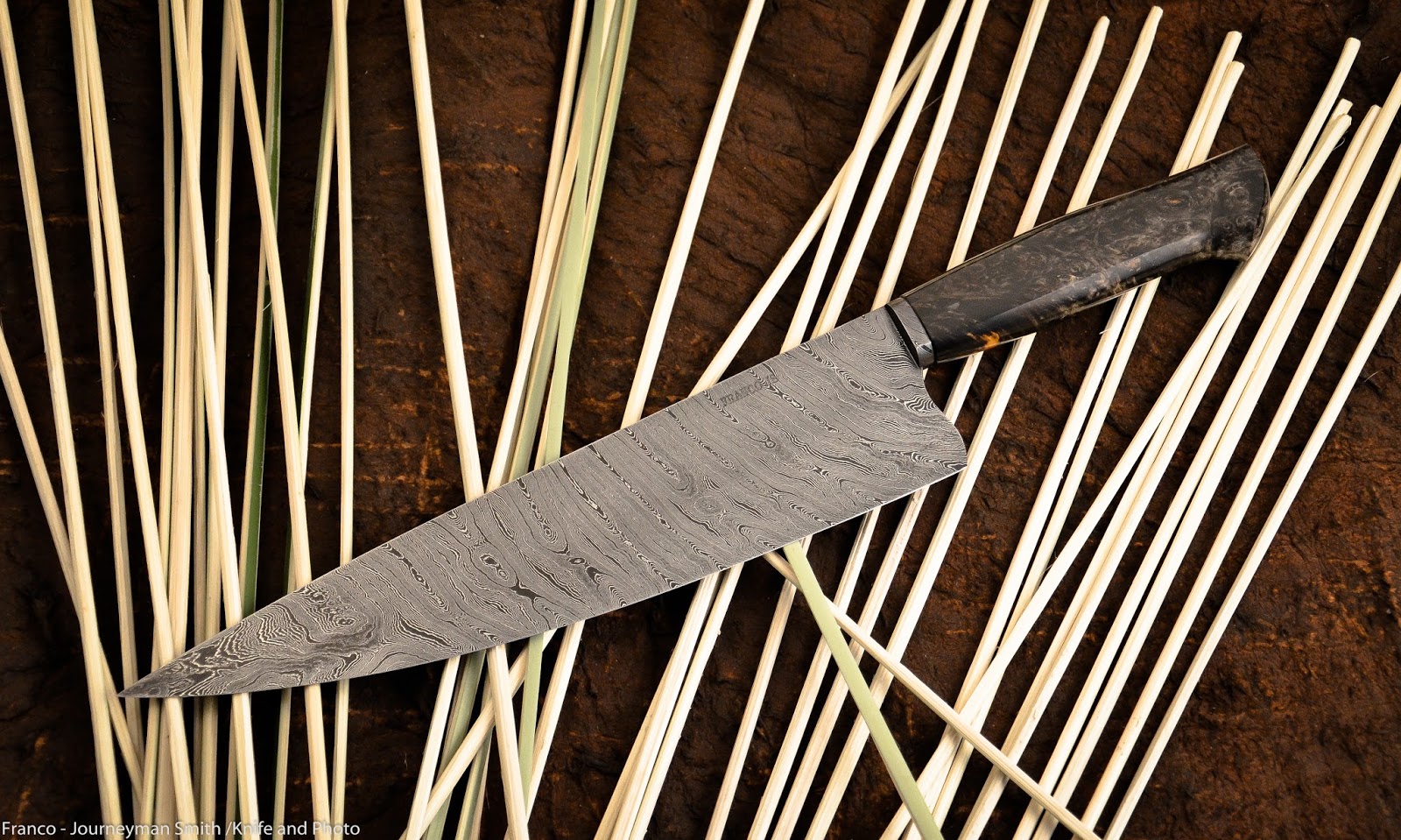

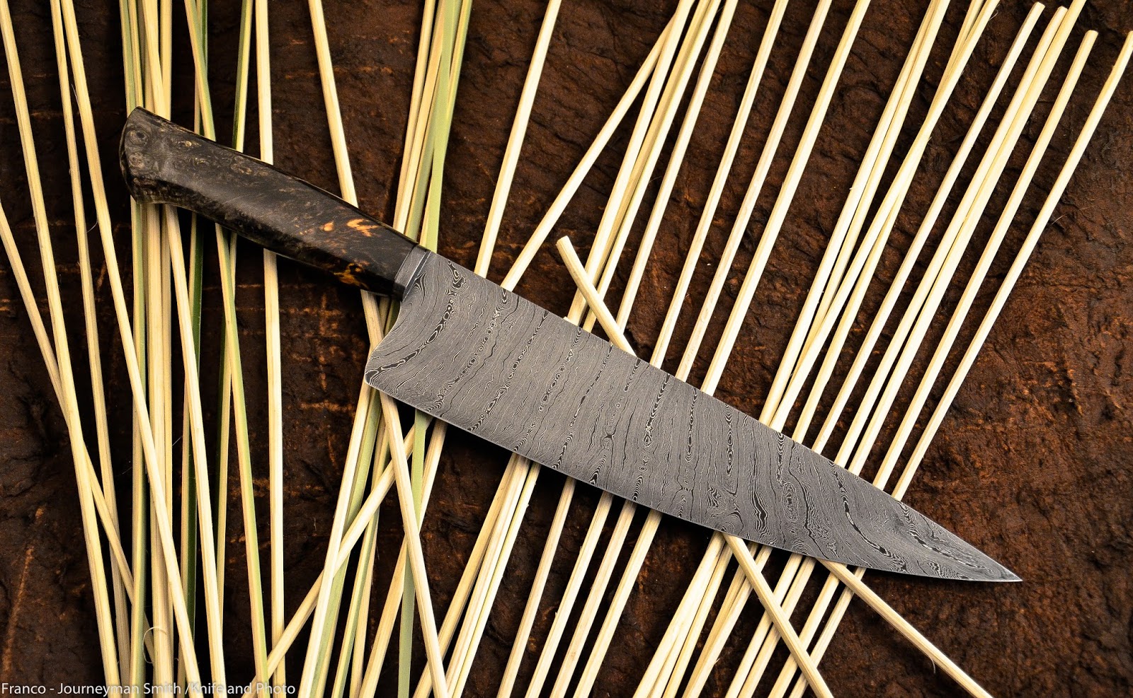

Hello Friends!!
I wanna present to you a recently work, named ´´Dream´´.
I put this name, when i tested the edge for the first time... i thought so much about the professional who will use this knife for many hours, give him handle confort and edge durability.
This is a cheff knife model, integral construction, twisted damascus steel, 120 lines , 1070 x 15n20 steel.
To the handle , i used a stabilized maple burl .
dimensions:
Blade length, 253 mm
Total length, 384 mm
Maximum thickness of the back, 2,8 mm
Maximum blade width, 58mm
The sheath is cow leather.
I hope you like, comments are really welcome!
Best regards,
Franco.

What can I say? It's a masterpiece! Definitely a job well done.
Question: was it forged to shape? I'm guessing it was because of the way the pattern "distorts"/changes at the tip.
Matthew.
Hello my friend Matthew,
Thank you for your compliment... i really apreciated!
Yes, i ever try to finish the blade on the forge( i love forge..huahuahuahua). this distortion is because the movement of the billet turning, round to flat and forming the tip...
