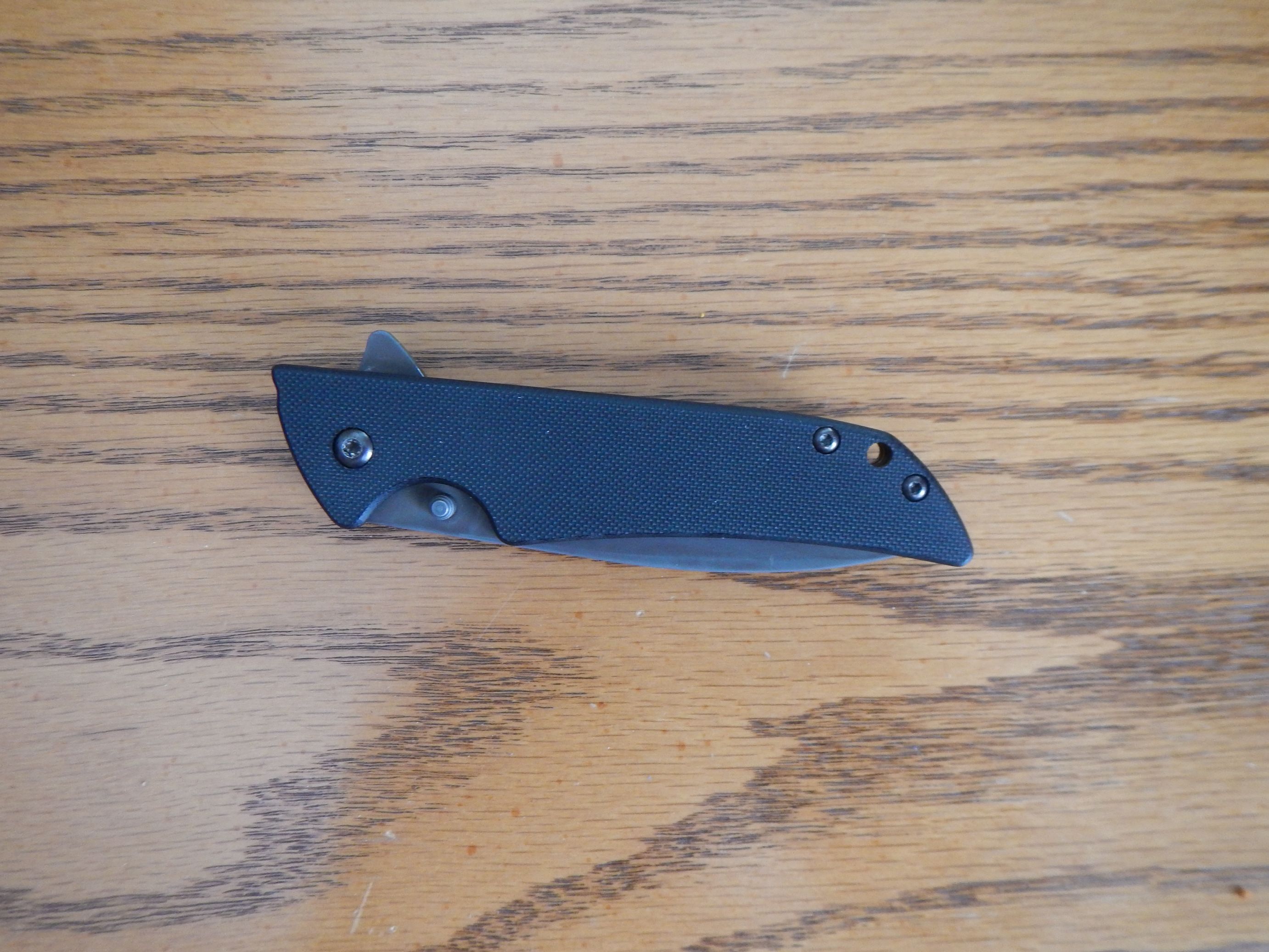

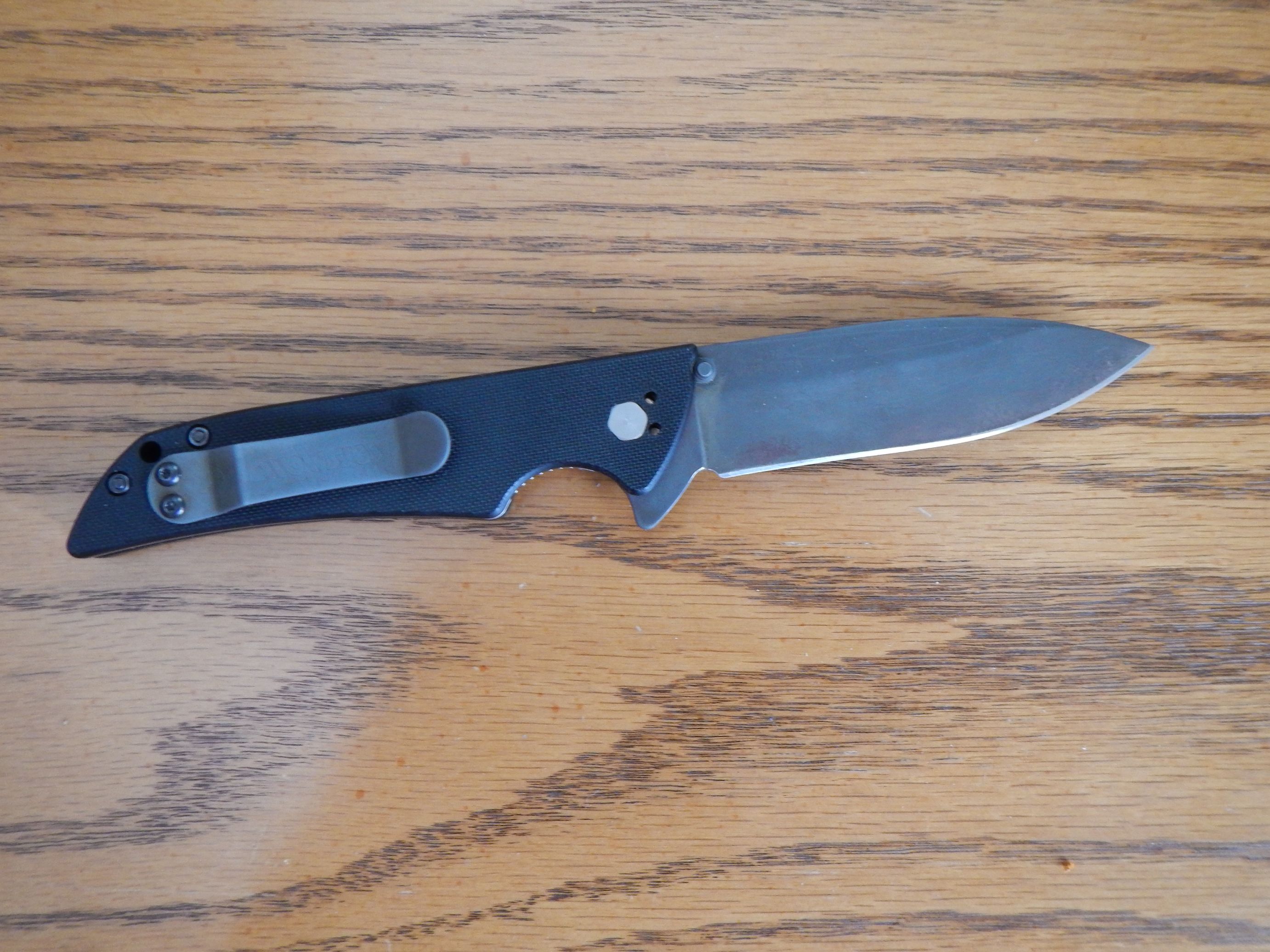

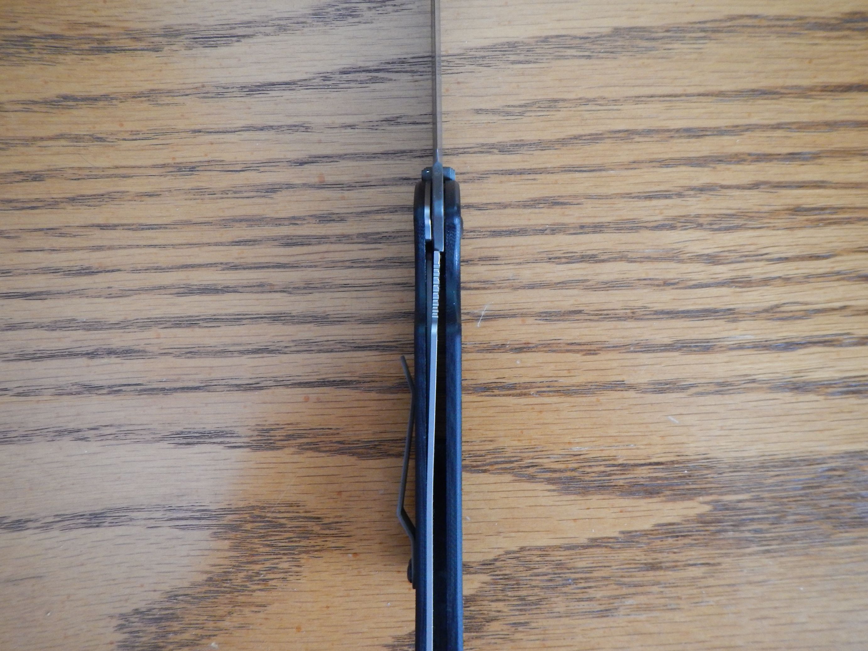

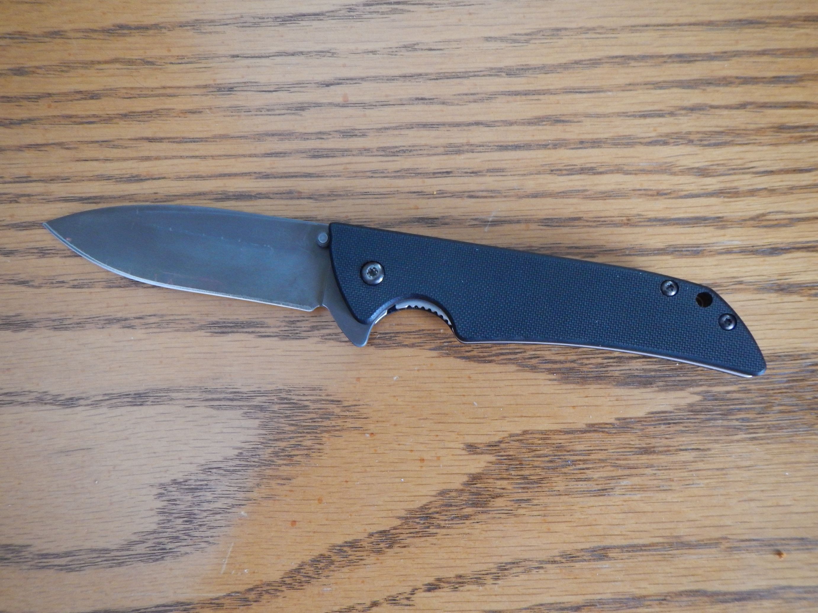

I didn't like the contrast in colors between the satin blade/clip and black hardware so I decided to give it an acid etch.
I botched the blade a little, as some nail polish got dried on, so I need to give it one more dip. It's still as smooth as factory, but somehow the detent got weakened so now it is a little harder to flip; still possible, just hard. It isn't perfectly centered now, but it isn't rubbing the liner so it's no big deal. Lockup is still fine. Decent job, we'll see if my scales will fit once they arrive.
