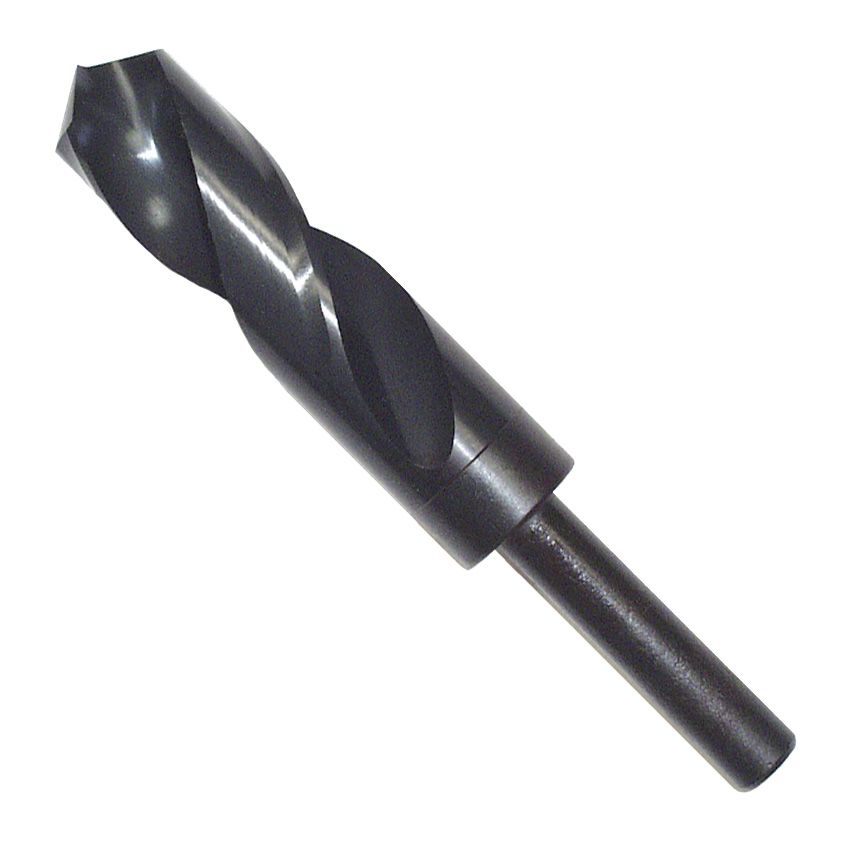

the minimum size is .197, but it takes a very large drill
For large drills, you can always use a Deming type drill with reduced shank size,
00966057000-1
or a Morse tapered shank
