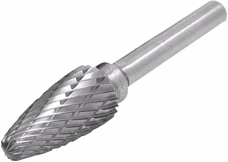

Hey all
I'm very new to knife making. So new in fact I've just made my first blade using stock removal from a file to create a simple Kiridashi style knife. However, I'm struggling to drill a hole for a lanyard, 4 bits gone to drill bit heaven so far! I'm wondering therefore, would annealing the material make it more drillable?
Thanks in advance

If you have to do one hole and you're breaking carbide drill bits, try a round end carbide burr in a drill press.
It takes longer, but it does work and will be resistant to grabbing and breaking the drill.

Carbide burrs work good if it’s hard and you keep the chips clear. Big problem a lot of people have when using carbide is going way to slow and not a ridged drill press. I just drilled 4 holes in hard 5160 with carbide drills,3/16 & 1/4”. I use the spade point style and run the rpm at 2500-3000. Just slowly keep pressure you will feel it bite.
