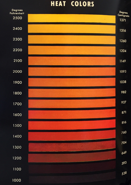

I think the key is going only to a very dull red and not going into the orange ranges when you heat the steel...at least while you're annealing. The normalizing step (first, before the anneal) will be more in the orange range.
While it's not a great reference for your steel temp, a chart like this can at least be a little helpful in telling what those different temperatures look like.
