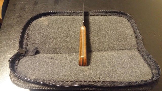

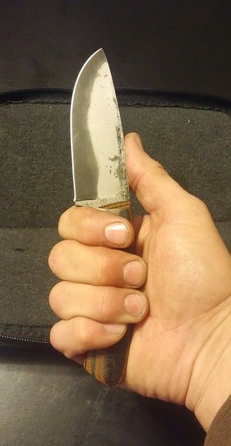

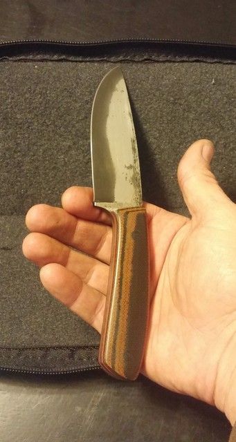

Drop Point Hunter
I used acid to force a patina and a very unique hamon showed up so I left it.
1/8" 1095 High Carbon Steel professionally heat treated to 59RC
Blade length 4" total knife length 8."
Primary bevel taken to .010" before sharpening
Black and brown camo Micarta scales with black micarta pins and red liners
