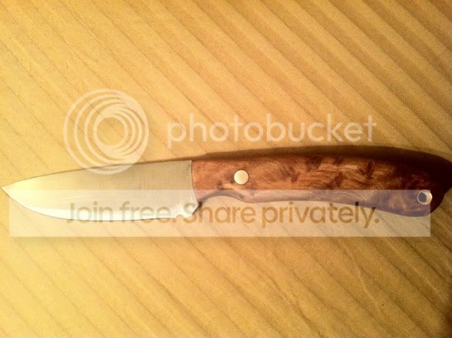

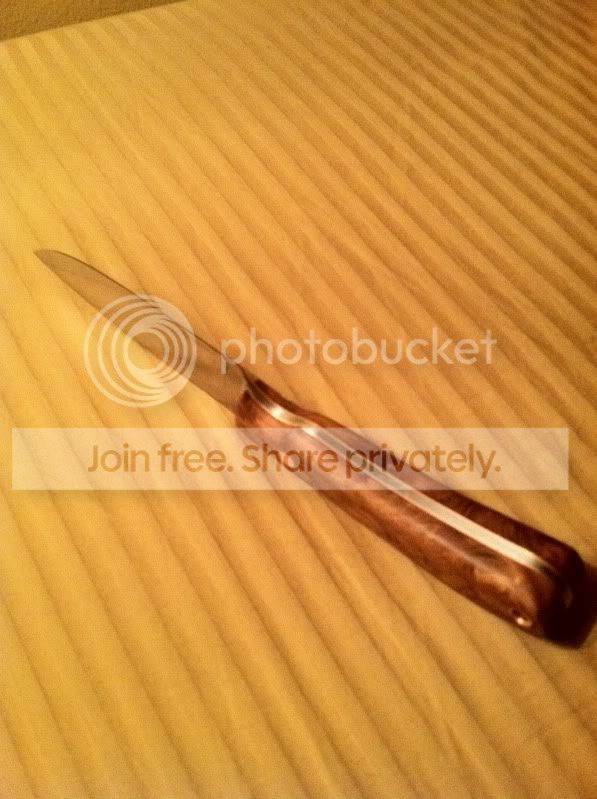

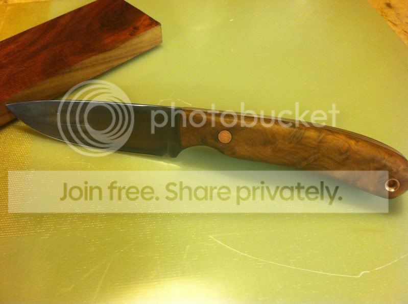

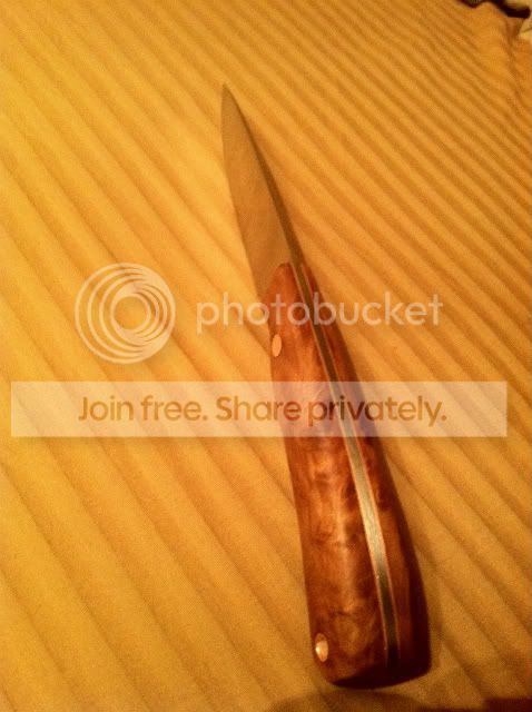

Here it is. Several serious flaws, but I'm going to do a 3-4 more and refine my methods. It was my first time forging and I had never so much as seen a video of someone forging...I forged the ricasso too thin and wasn't smart enough to upset it thicker at the time. I totally screwed up the plunge and ended up with a depression....:(:rolleyes: Oh well....:D:D
8-1/8" OAL, 3-3/4" blade. It's from 1080 bar stock from Kelly Cupples. Stabilized Redwood burl from Mark Farley.
It has copper liners, a copper corby and a copper thong tube. It just gave it a light coat of oil and it needs oiled and buffed out a bit more.
There's a few deep scratches that I left as I forged the blade pretty thin for a hunter and didn't want to go much thinner, a few other issues, but overall happy with the result. Very happy with the look and am looking forward to making several more.
My HUGE thanks to A C Richards, and Greg Haile. Chuck for the lessons, shop time, helping me with the heat treat and ESPECIALLY the smoked ribs......And to Greg for the use of his shop so I wouldn't go nuts waiting to get into mine...The difference between this first forged blade and the other 3 I have forged is huge. I can't wait to get the handles on them these next couple of weeks.

A few things I learned... I burned the wood around the corby in the early shaping process...:eek: I was able to get that out, but AFTER the handle was shaped I cleaned up a spot on the spine with my grinder and got dip bucket water on the handle...:o:( metal dust sure turns wood black fast. The ring/halo around the corby is not burnt, it's metal dust stain from the water..:(
When drilling the holes in the liner to match the holes in the tang I added a few divots for the epoxy and got one too far out and after glue up have a divot at the scales edge that shows.
I also need to write on the wall the corresponding grit sizes for my Gator belts...A30(600) really doesn't take of much metal....;) that took ten minutes to realize.....
