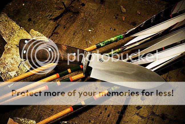

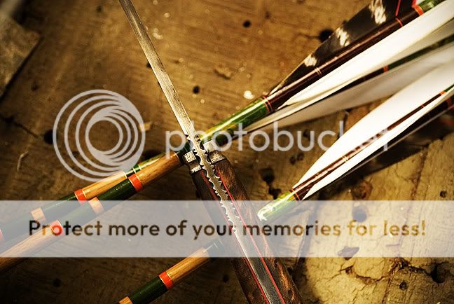

Here is something a bit more polished for me... and... I like it.
It's 8" over all and forged from 1084 and a bit of clay on the spine. The wrought guard is forged from a spike salvaged from a Lake Erie steamboat wreck.. the F.H. Prince, 1840. The file work is my typical random wave pattern. Wood is stabilized redwood burl from Burl Source. This knife was traded for some exquisitely crafted traditional longbow arrows.. pictured.
