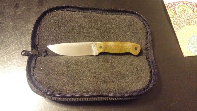

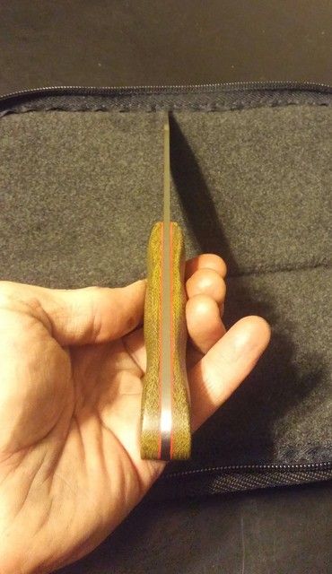

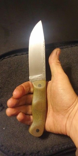

I actually like the way this one turned out, I am working on the funds for a big boy grinder but am learning the quirks of the Crapsman 2x42
1/8" 1095 High Carbon Steel professionally heat treated to 59RC
Blade length 4.5" total knife length 8.75"
Primary bevel taken to .010" before sharpening
Olive Micarta scales with black micarta pins and red liners
