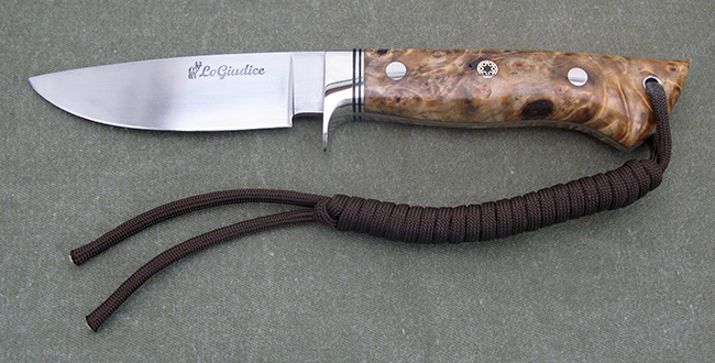

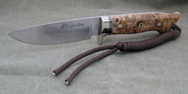

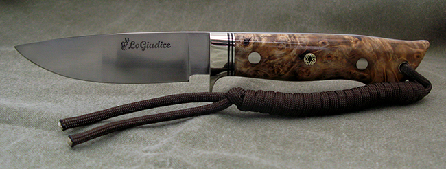

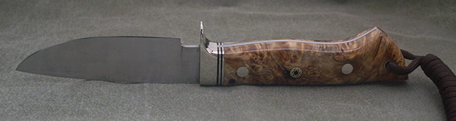

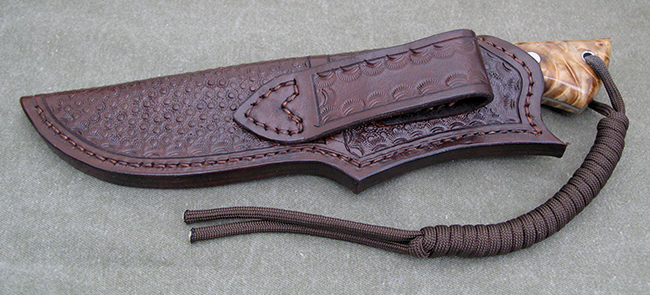

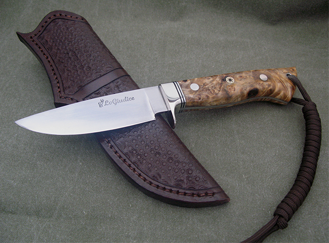

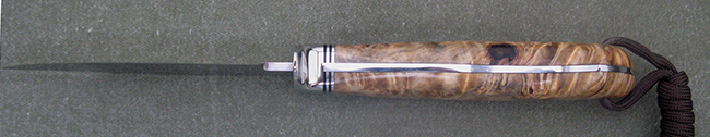

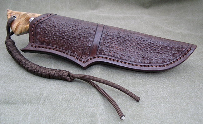

I'm sending this knife to a customer on Monday. Before it leaves here, I thought I'd post a few photos and specifications.
Specifications
Type: Drop Point Utility Hunter
Overall length 8-3/4 inches
Blade length 4 inches
Blade steel Hand ground ATS-34 stainless steel, 800 grit hand rubbed finish, tapered tang
Heat Treat Peter's Heat Treat
Grind type: Flat
Handle material: Buckeye burl wood
Guard material: Hand shaped 18% nickle silver, pinned & soldered
Guard spacers: Black vulcanized fiber and 18% nickle silver
Fasteners: Nickel silver corby rivets, mosaic pin by Barry Posner, nickel siiver lanyard tube
Lanyard: Olive green parachute cord
Sheath: Hand made, tooled, dyed, and sealed. Dk.. brown stain, stippled tooling pattern
Thanks!
