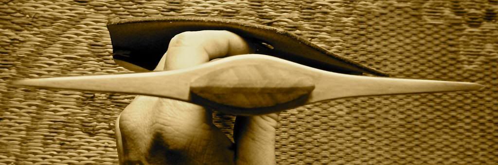

Lee Reeves is a name that often comes up with double bits, he makes a small Nessmuk style axe. I waited for over a year to get this one--- it just showed up. The fit and finish is excellent but I haven't taken it out to play yet. Overall haft is 15 inches making it more of a hatchet. The last pic shows the two grind profiles: splitter on the right and fine on the left - both convex. The walnut is clear and straight grained with a walnut wedge...

Russamurai, could you give a rough estimate of the weight of the head? so i might be able to find a dual bit head about the same weight.

yes. I'm interested in how it performs next to a hawk. The bit is more substantial than you'd think. For splitting larger logs, I'd probably wedge the fine bit deeply into a stump and split the log with a club straight down over the second bit. Gonna give it a shot today.
