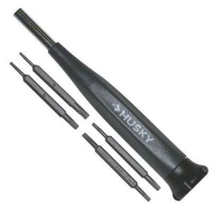

I have a Buck Redpoint 750, which I like very much aside from the blade play. I thought about tightening the "pivot point" (if that's what it's called) to reduce the blade play. The screw is so small, I can't really figure out whether it's hex or not.

I don't own that particular knife - but on the other bucks that I own (and on most other knives) the screws are torx heads.
The size is going to be up to you to figure out (unless someone else here has that knife and knows offhand) but probably somewhere between a T5 and a T8.
I purchased a precision screw driver set from a local hardware store that had T4-T10 (along with a bunch of other bits) for about $10.
Check out Husky Torx Driver at Home Depot for $6 bucks. I haven't run across any production knife with a torx screw that this little tool won't fit.
http://www.homedepot.com/webapp/wcs...87664&catalogId=10053&storeId=10051&langId=-1
I'd definitely grab a torx set, especially if you plan on getting more than one knife, which is a safe assumption on bladeforums. That said, I've never had Buck customer service take longer than a month, or do anything less than a perfect job. So that's another option. Is it side to side play, or up and down? If up and down, I would definitely send it in, due to its unique lock.
i'm not sure of the redpoint, but IMHO, majority of Buck screw heads are t-6 torx. jec is right that a set would be good, some, i believe, t-8 pivots on larger liner locks like the alpha hunter, kalinga and csar-t.
