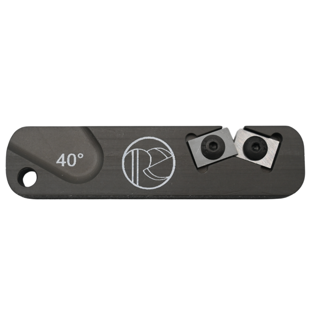

I'm looking to create a dummy proof, lightweight, full spectrum, SHTF sharpening kit (that can be perfected by a 6th grader).
Quality of finished edge is not as important as "good enough"
Here is where I am, would love feedback on specific coarseness changes...
Get it back to goodish within 5 minutes or less
1. Carbide Pull-Through - (scrape off effed-up and mangled metal... approximate it back to a "cutting edge")
2. Strop Paddle (Black Stropping Compound) - take the "approximated cutting edge" and coarsely refine it a bit

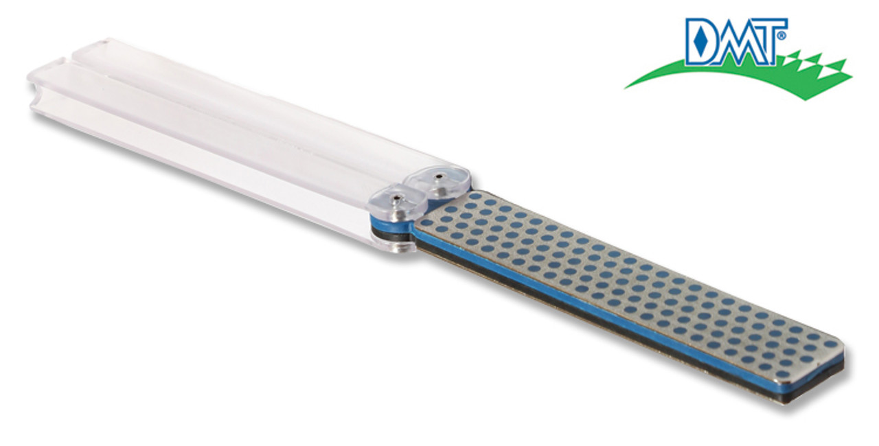

Okay, have some time in camp to work the "approximated cutting edge" back into a refined edge.
1. DMT Diafold Magna-Guide Kit (with 1-Double Sided Black/Blue - Extra-Coarse/Coarse)

For 'good enough' or even for 'plenty good' field sharpening, I'm also inclined to favor a simple pocket hone and little else. The dual-sided Dia-Fold shown in the OP would be just fine for that, either in the XC/C configuration shown (Black/Blue), or in their C/F pairing (Blue/Red). Either are capable of doing repairs to heavily damaged edges. And a lighter touch with the finishing side of either one will produce a great working edge for pretty much any use except shaving.
I wouldn't bother with the pull-through at all. They have the potential to leave as much weakened & damaged metal as they remove. The scratch pattern it creates, being parallel to the cutting edge, will leave the edge weak & unstable. Edges routinely sharpened on them will need more frequent resharpening for that reason alone. For just setting initial bevels, the XC DMT (black) will be plenty enough on its own and the scratch pattern being perpendicular or diagonal to the cutting edge will leave the edge much stronger & more durable, and the edge's cutting action will be much more aggressive as well.

Keeping that simplicity in mind, I would most strongly favor a folding double sided DMT stone.
