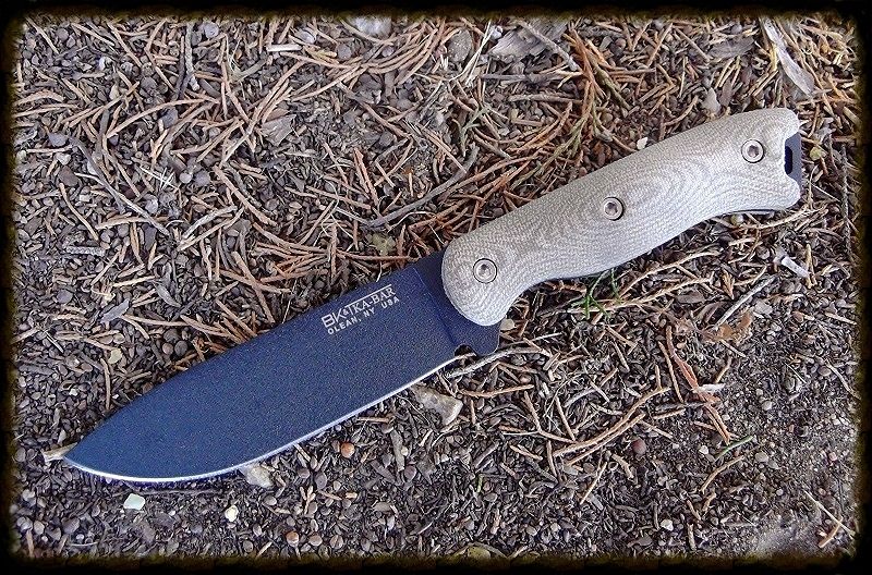

I didn't like how light my micarta was. I know they darken with use but I was looking for more than that.
First I sanded it with 3 grits of sandpaper (120- 400-1000) getting it nice and smooth. Cleaned it with a rag and dyed it with the Fiebing's professional oil dye I use on my sheaths. Several heavy coats. Color was light brown. I let it dry 3 days, wiped it down with paper towels and then rags. After that I cold waxed it with beeswax and polished by hand with a rag.
I'm very happy with how it came out. Hopefully it holds up long term without bleeding out. I have been using it for about a week with no noticeable stain coming off on my hands and gloves so far.
Pics :)
Before.

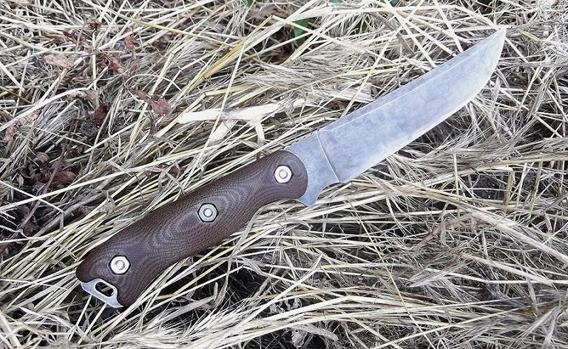

After. In the sun.
In the shade.

I would much rather the set youve dyed - look brilliant! I prefer the darker colours of timber and usually dont bother with Micarta, Id be very happy to sport a pair of these though. Well done man.

Those look great! Nice work. I may dye the micarta on my necker one of these days.
