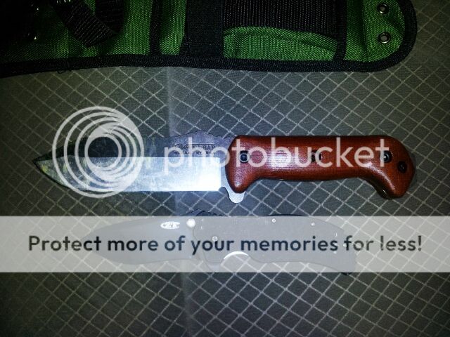

Dyed some more micarta
Dec 10, 2011
302
Sanded with 60 grit to knock off the rough edges.
Poured RED Rit dye into sauce pan. Added a smidgen of BROWN Rit dye into the red.
Salted the dye and put on simmer on gas stove.
Dropped in bk10 micarta, stirred and simmered about 10 minutes.
Poured into bowl. Made sure the micarta was covered by the dye.
Tasted.
Let set 12 hours. Pulled out, set 8 hrs (or till dry).
Washed micarta in cold water. Dried it off.
Applied Formby's tongue oil. Set another 8 hrs.
Applied to bk10.
Peace,
Steve
Beckerhead # three zero three
Nice work, Revenuer. I may have to do the same to my BK-10. I like the factory micarta, but it looks too pale for the stripped Crewman. That reddish brown looks good.
It came out really nice. Its got a better look than my bk11 dyed micarta.
I used a diff recipe on the bk11 micarta. I'm perfecting the dying process slowly.

complete newb question, what does the formby's do? is it a surface sealer to make it shiny, or another purpose?
im getting set to do the same thing, but more oxblood color
It seals it. Helps to keep it from fading etc. You don't have to use tongue oil. There's diff sealants out there. Its just what I picked and it works.
