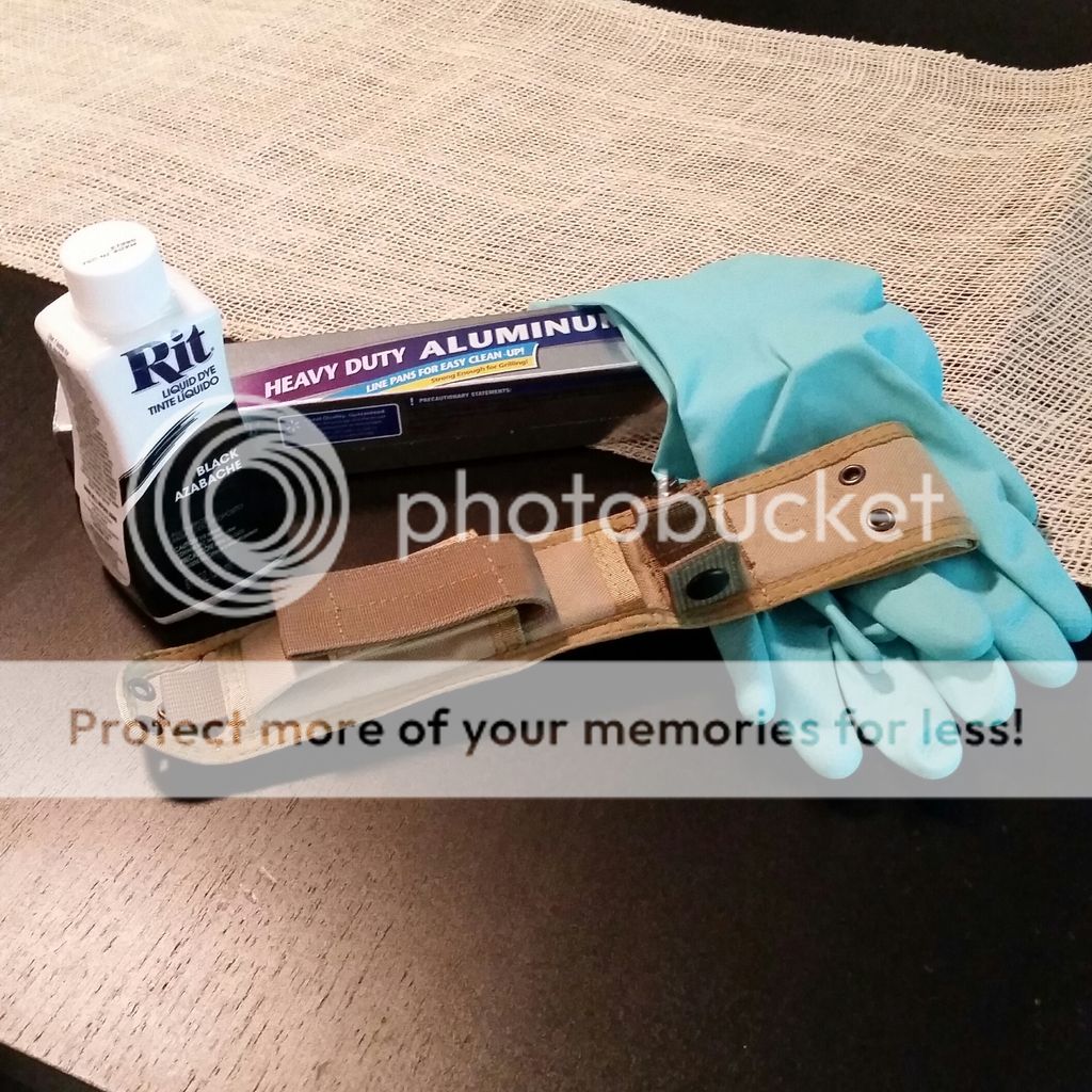

Recently, I was very blessed to win a new KA-BAR/Becker BK15 in a giveaway over in the BK&T subforum. LOVE the blade - not a huge fan of the tan sheath. I considered getting kydex for it, but do like having the tool pouch on the front. So, after some consideration, I determined to take a shot at dyeing the factory KA-BAR sheath black. So, I picked up some supplies this afternoon:

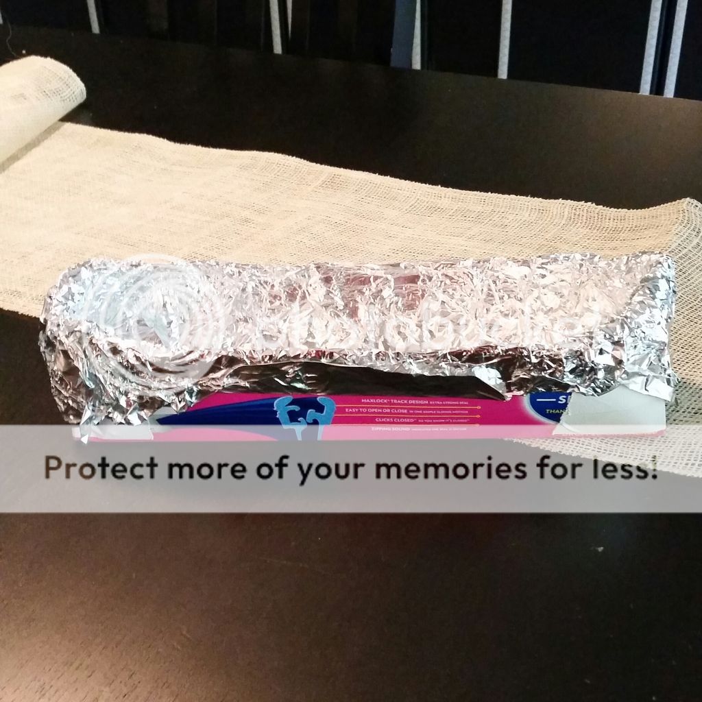

I used 3 layers of the aluminum foil and an empty ziplock bag box to make a dyeing tank (I'll do this differently next time - more to come on that in a moment):

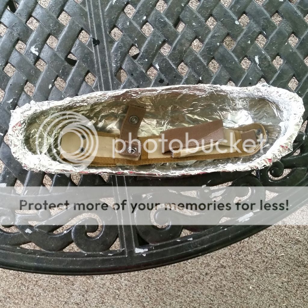

I soaked the sheath in hot water because I heard it would take the dye better if I did:

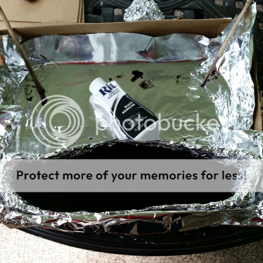

Next, I filled the tank with about a cup of white vinegar, the whole bottle of RIT dye, and topped it off with boiling water. Then dunked the sheath in it (promise there's a sheath in there):

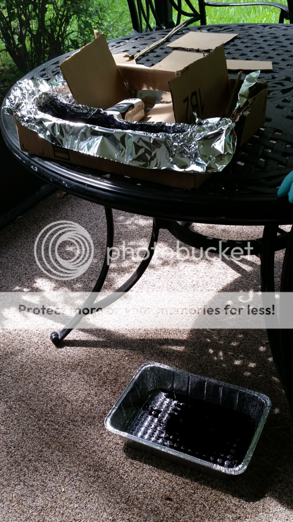

As I was sitting there working on a couple of things, I heard this drip, drip, dripping sound and noticed my tank had sprung a leak and soaked through all my fail safes. I got a disposable roasting pan under it (glad I did this outside):

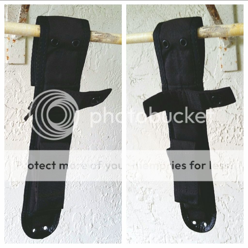

I left the sheath in as long as it was submerged in the dye. I was afraid it hadn't had enough time to soak, but I think the final product came out pretty well! This picture was taken about 5 minutes after it came out of the dye:
I checked it when we got home from a friend's house after watching the Stanley Cup playoffs. It'd been hanging to dry for about 6 hours and seems to still be holding its color well. We'll see what happens when it starts getting used. Planning to do the sheath for my BK16 next. I'll probably do a couple of things differently but overall, very excited about the outcome. My wife was even impressed!
