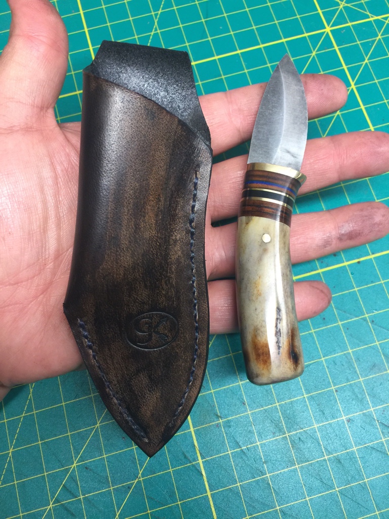

I dye all of my antler handles with Fiebings leather dye or leather finish in different colors. It works the best of anything I've tried. Here's a couple of pictures of a couple I've finished.
But also sometimes I take a torch and "burn" the antler a little sometimes. Hope this helps.
Fiebings oil dye works well for me too, even on areas that have been ground/sanded bare.
Man, I bet that burning thing smells good[emoji3] Seriously, those knives look great!
