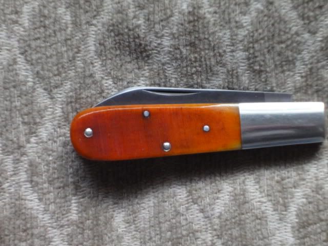

Anyone have advice on how to get this bone to look a darker, more mottled color with more brown or caramel tones? I read that leather dye might work but if there's anything else around the house that will work or any tips on how to go about the process I'd be glad to hear them.
Thanks.
Looks like some of my options are tea, coffee, rit dye, leather dye, and potassium permanganate but I'm a little leery of doing the work with the bone on the knife. I'm assuming to much heat could crack or harm the bone. Will allowing it to soak submersed in a solution do any harm?
Leather dye or potassium permanganate will dye it while on the knife. Apply with a Q tip. Don't soak it-use multiple coats. If you use leather dye, try a lighter brown. Dark brown will come out almost black.

Well, here's the final outcome. I used a combination of extra strong brewed coffee, Kiwi brand black leather dye and red food coloring. Not necessarily in that order but different combinations of the three. I'm pretty happy with it, would have liked it even darker but it just wouldn't get there.
I may still try some of the leather dye in burgundy.
More pictures after an application of Fiebings leather dye (burgundy). I just wiped the bone with a q-tip soaked in alcohol then wiped dry, followed by the dye and let it soak until dry. After it was all dry I wiped it down with some mineral oil. I'm pretty happy with it now!
