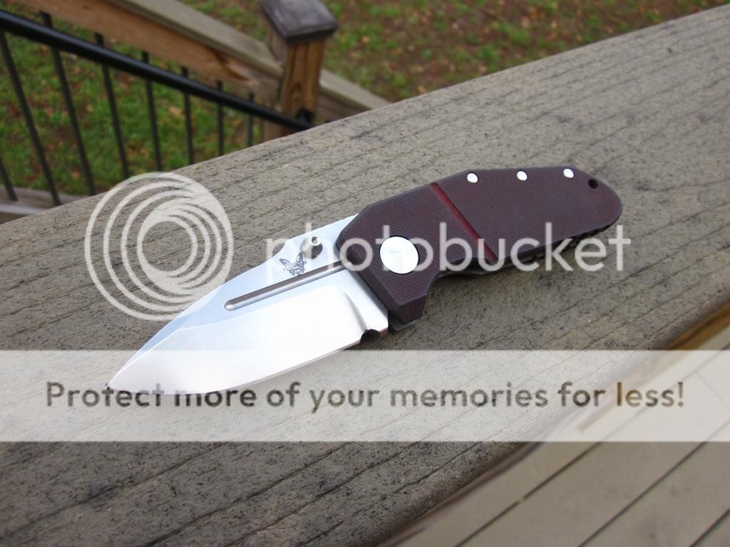

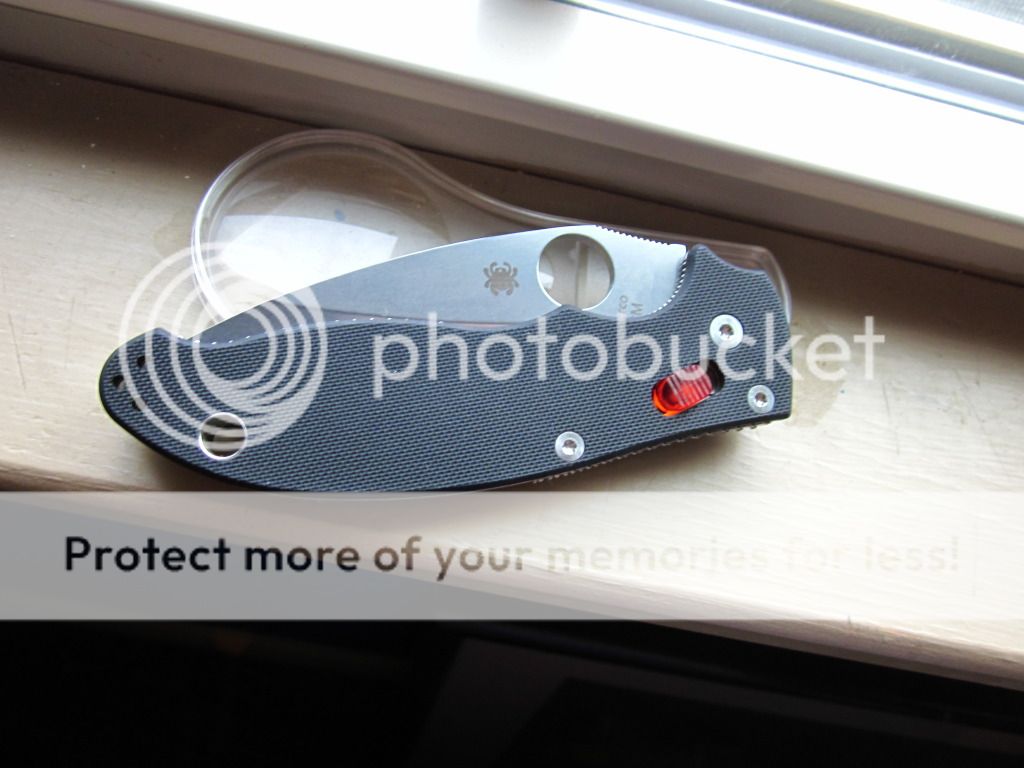

That's pretty much it. I hope that makes sense. Here are some of my knives I have dyed using that system.
Ball cage
All of those knives were dyed with the same packet of rit dye and I still have a bunch left.
