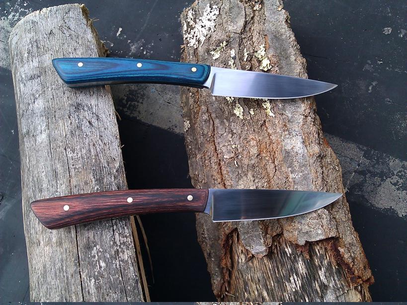

I've put it on 2 knives and like it well enough. It tears out more than a good dense small-grain natural wood, but it finishes smoothly. I wouldn't put it on a BBQ knife, but on these paring knives it seems appropriate to me (and my cousin LOVED the blue on hers).
I have a couple more pieces of the stuff and keep passing it over, but not because anything is WRONG with it, IMO.

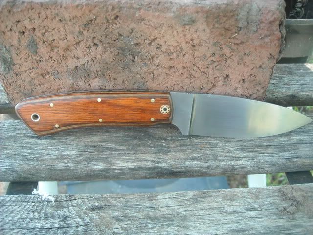

I've used it on a few knives. I think it's durable, but I just wasn't all that crazy about the finish. I wanted a higher level of finish and no matter what I did, I couldn't get it to the point it satisfied me. Of course, those who received it just kept going on and on about how beautiful the handles were...

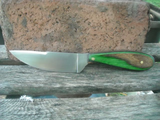

The walnut on the ones I had looked washed out. Hard to see it on this one.
You can see what I mean on this one. This is the one that was the most popular with the lady folk. They loved the green.
