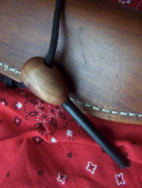

Go to a hobby place or craft section of a large store and check out their large beads. I found large wood ones with a 1/4" hole that fit small rods.

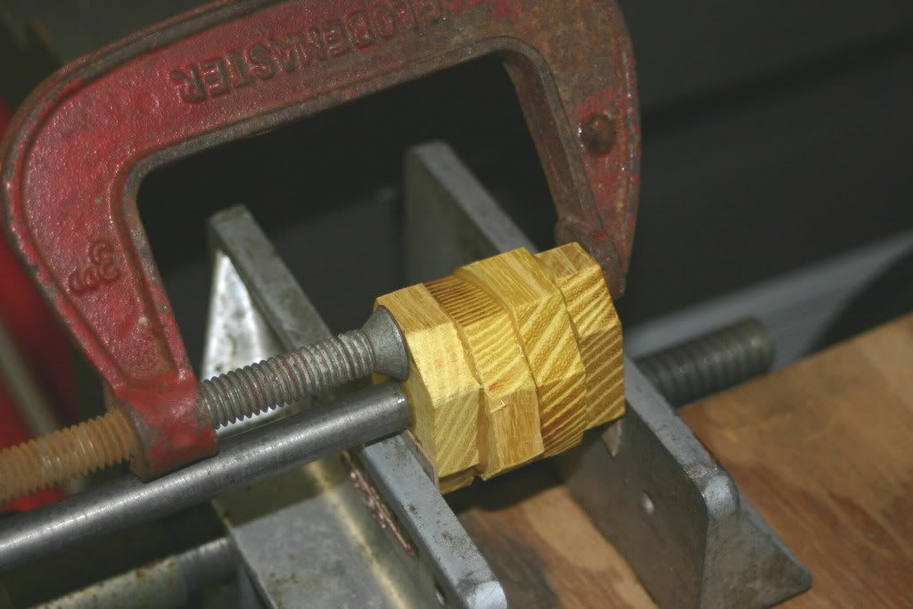

Thanks for the kick in the butt I needed to get this project off the ground....I've been thinking of doing this long enough, so this morning....here we are.
Somebody say big bead?.....this is gonna be one big bead...the rod is a big ole honker, 5" x 3/8".
I cut up some Osage scraps, drilled the holes a wee bit larger than the rod, epoxied everything together, and vised it....now we try to leave it alone for a few hours...
24 hrs. later, 10 min. on the belt sander, some hand sanding, Danish oil, all done....

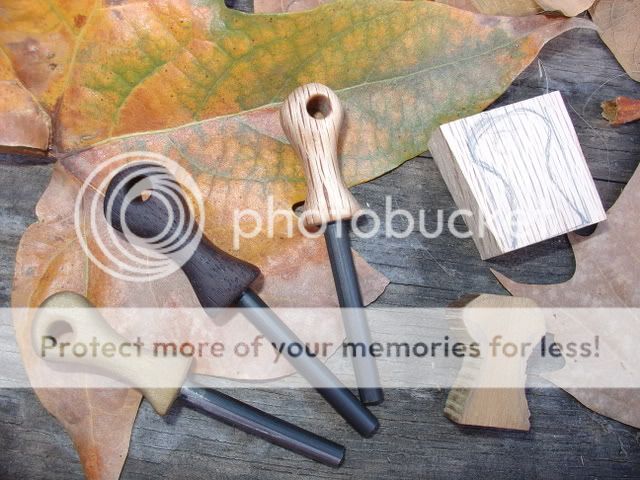

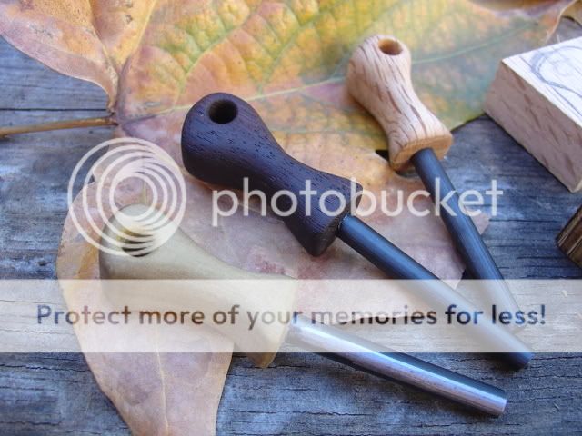

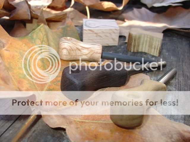

Here is how I do it. I cut up scap wood into little blocks, draw a rough shape on them, and cut them out on my band saw. Drill the hole for the blank. Then I just use really gritty sand paper taped to a piece of steel conduit (you can use anything cylindrical). Once I have it shaped with the rough sandpaper I just switch to finer and finer paper until it feels done. A little mineral oil, and presto!
Block with shape drawn on and block after cutting out the shape.
Finished Product
