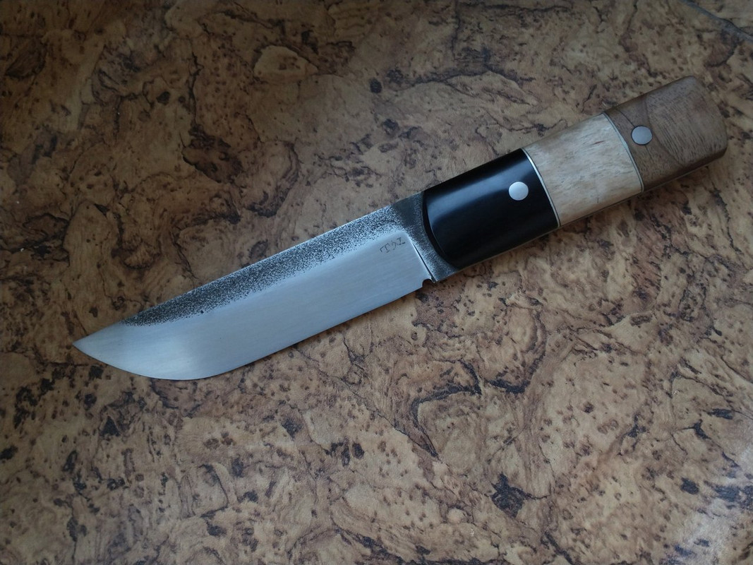

Ashenforge Joined Aug 29, 2015 Messages 71 Feb 29, 2024 #1 Overall length: 8.6 inches (22cm) Blade: 4.7 in (12cm), 5/32 Materials: walnut, D2, beech, hanex, The blade is heat-treated in a temperature-controlled kiln. Air hardened in foil. 61HRC. Flat grind, with 30deg secondary Feel free to ask me any questions in the comments or DM
