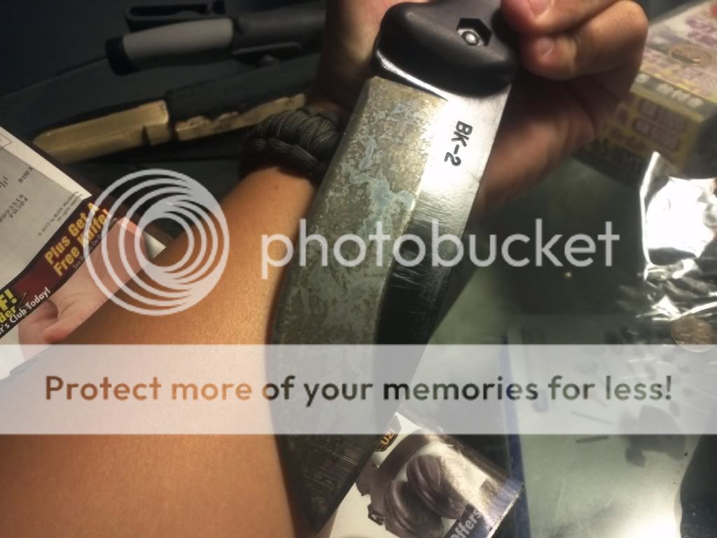

Jolly Roger on my bk2. Done with blue painters tape, a skullcandy headphones decal + vinegar and brown mustard for the patina.
I didn't like the papertowel+vinegar on my small blade - looked like it had the measels.
The maskings are great, tho.

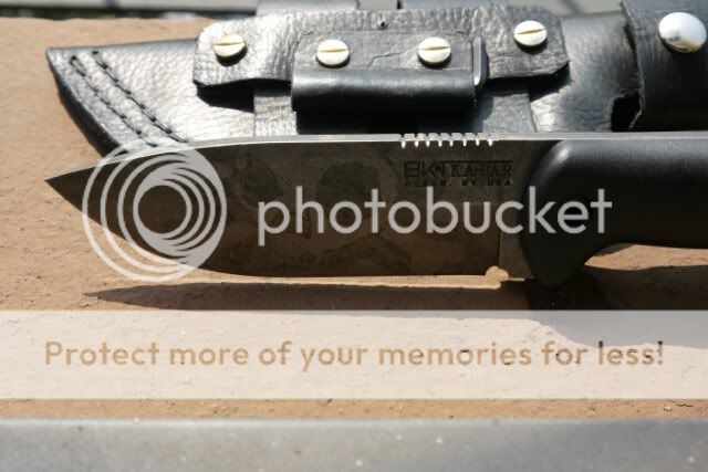

After a acv bath I decided to take a stencil I had and with masking tape etch a skull into my blade, can work with vinegar or your patina producer of choice, I ended up using PCB etchant solution uploadfromtaptalk1347981702575.jpg
