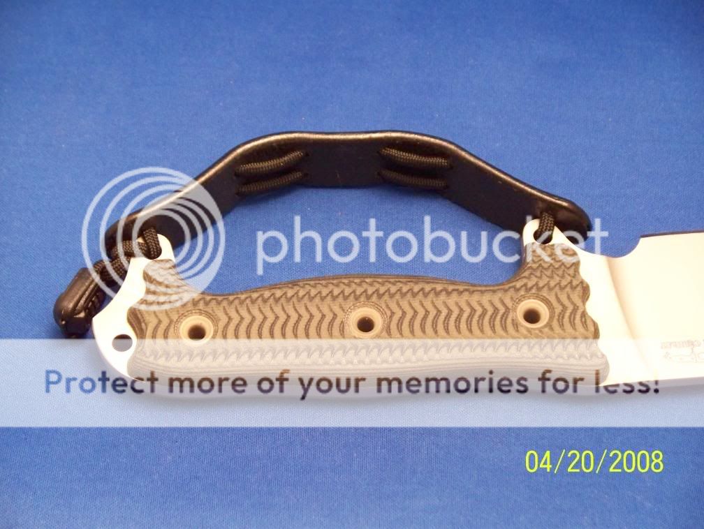

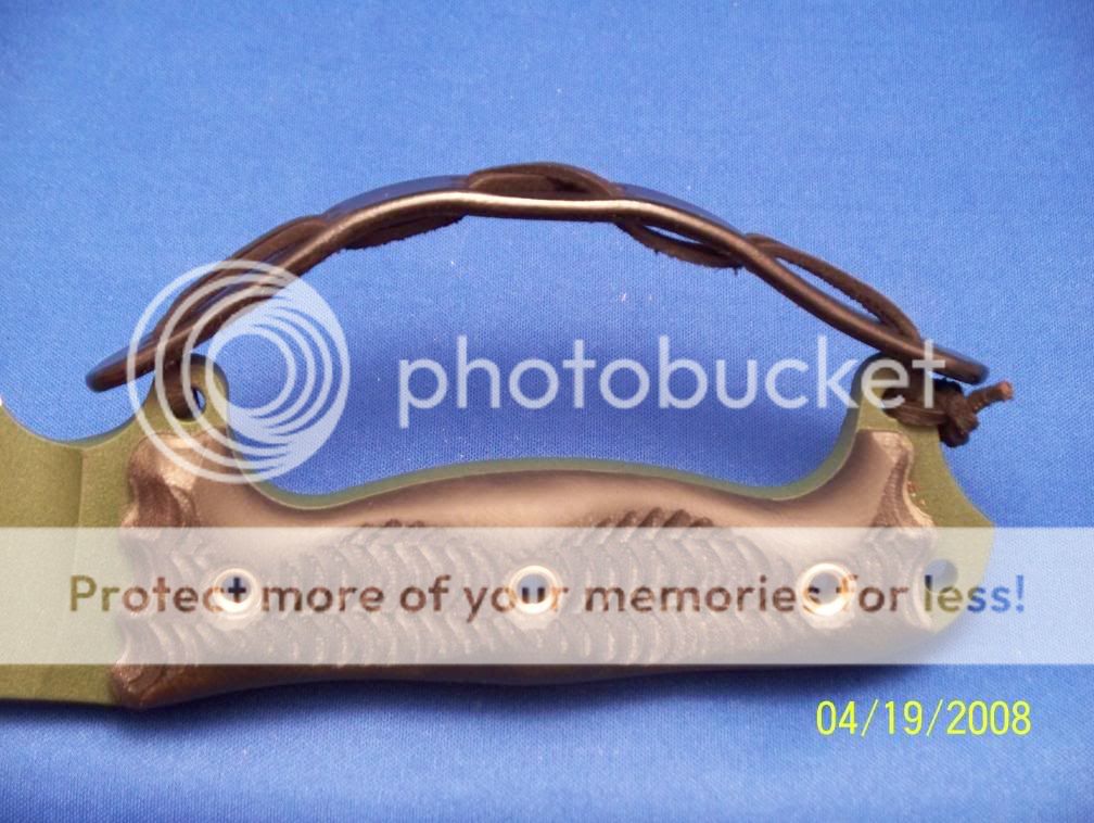

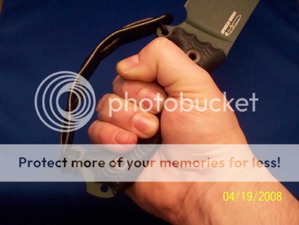

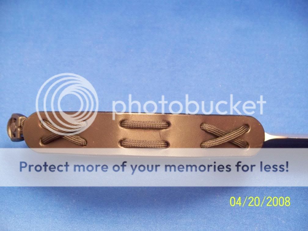

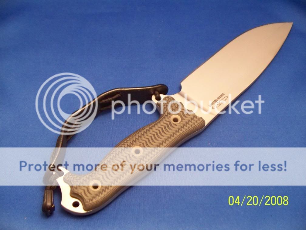

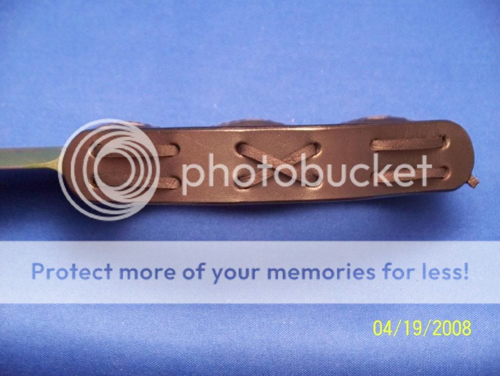

I have been working on an easy to make d-guard for a while now and this is it in its latest form. It is one piece of leather with a few holes which let it be tied on with leather or paracord. I tried to keep it as simple as possible yet be useful and easy to swap between knives of like size. If anyone has any ideas for improvement feel free to post them.
That looks like quality work to me , and the leather looks good on those slabs. My only question is if you could reconfigure the strap so it is doubled up in the talon hole near the ricasso (rather than the one at the butt -like in the pics), because I think thats where all the tension will be during use.

Good idea. I was thinking of something similar, if you want to make it real easy to swap out, skip the leather and use paracord with a cord lock on the end to cinch it up.
i like that, great idea. how wide is the strip of leather? :thumbup: :cool:

It is 1 inch wide by 6 inches long. I picked up the paracord end at county.com

I'll take it! How's it feel when chopping? And are you going to sell them?
:o I have yet to take it out to do anyting with yet. I have chopped with a paracord d-guard on it and I liked it.
