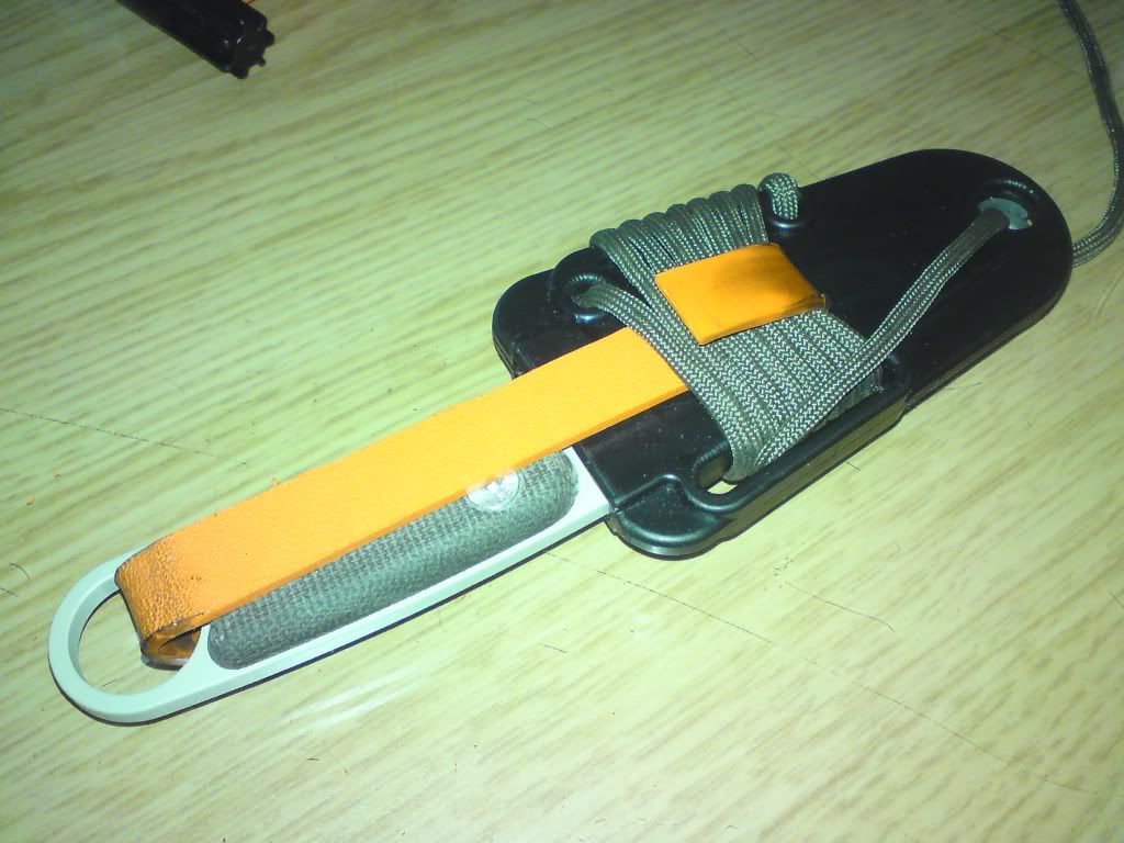

Hi guys!
Some weeks ago i made this small piece of kydex and fitted it to my Izula for low ride belt carry.
Have tested it for 2 weeks now and it works like a charm.
It sure doesnt look pretty, but its very functional.

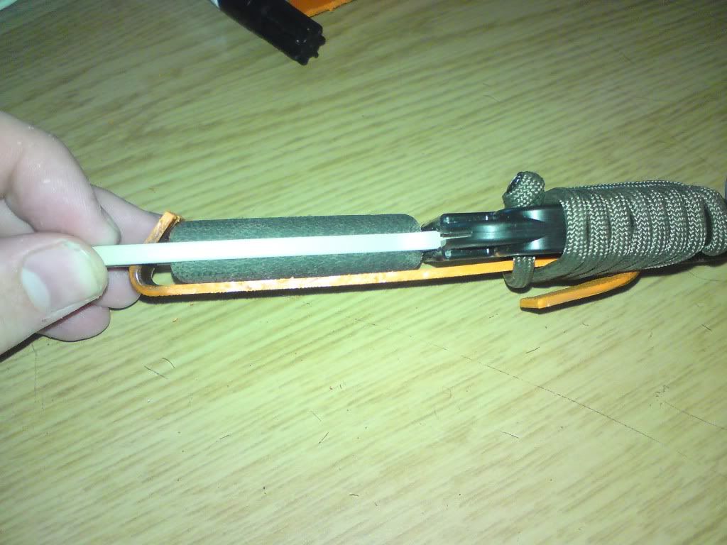

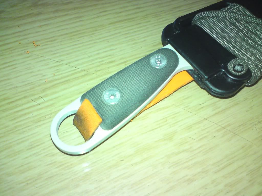

It is both belt "clip" and a number 2 lock for the blade, it cant come out by accident with this setup, secure as hell!
Its simply just a strip of kydex which is bent in both ends and is held in place by the paracord wrapping around the sheath.
Pics:

Once you disengage the lock/clip, does it wobble around or does it stay put pretty well?

I'm not sure is the Kydex will be strong enough, and I'd prefer a bit more cant -
but I like the ease of removing it from my belt. Not as quick to grab, but I guess time will tell if this is a viable option for me...
When i pull the knife out, the sheath remains in it postition, if you have the belt rather tight. I was thinking about adding another strip of kydex on the back of the other one so it creates a belt loop. Which will be more secure.
But ive used this for 2 weeks and it hasnt failed on me yet. I used .093 kydex.
