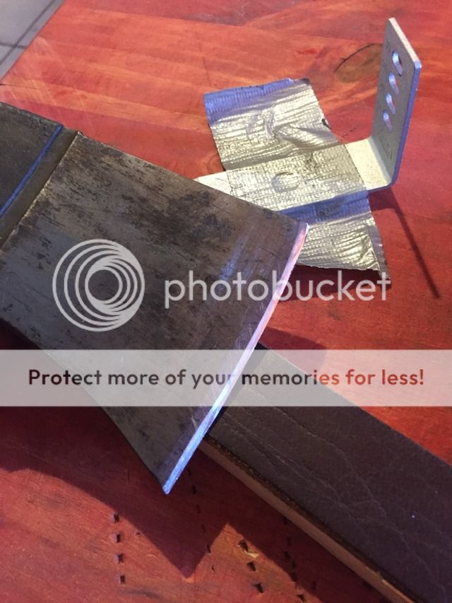

I know this is not a new idea, but I sharpened my Fiscar x150...22inch long AXE today using my Lansky Diamond sharpener and it cuts paper almost as good as my small EDC knives, which is insane to think an AXE can be as sharp as a SAK or Folder.
Basically, just put one of the Lansky guided sides flat on the AXE shaft and hold it with one hand (you could use wood clamp too for quick release and more steady) I used duck tape and it worked great too and free hand.
I use a small c-clamp to hold the guides on each side of the axe.
I sharpened this Estwing like that.
The C-clamp I use is a short deep one, works great for this.

So sharpening an axe the way I did in my opening post it was a real pitta.
I went to my local Harbor Freight and found the Swivel Table Vise.
http://www.harborfreight.com/2-1-2-half-inch-table-swivel-vise-97160.html
It actually allows my Lansky guided system so I never adjust anything on it. Just clamp in the axe head along with the guided clamp and that's it. they I put it on 25 degree and it actually made my AXE incredibly sharp scary to think an AXE can be as sharp as a small fixed blade.

The best part is you only put the axe once and leave it there. You don't adjust anything or turn over the axe to do the other side like you normally would using a lansky guided. This is the exact same way the wickededge sharpeners work and hence where I got the idea.
It only works on AXE's this way but I suppose if I had a tiny swivel vise I could try using my EDC fixed blades to see if it worked.

If you prefer a convex edge on your axes (like I do), you can bend a gentle curve in the guide rod attached to your stone. Then that same gentle curve will be applied to the axe edge.
