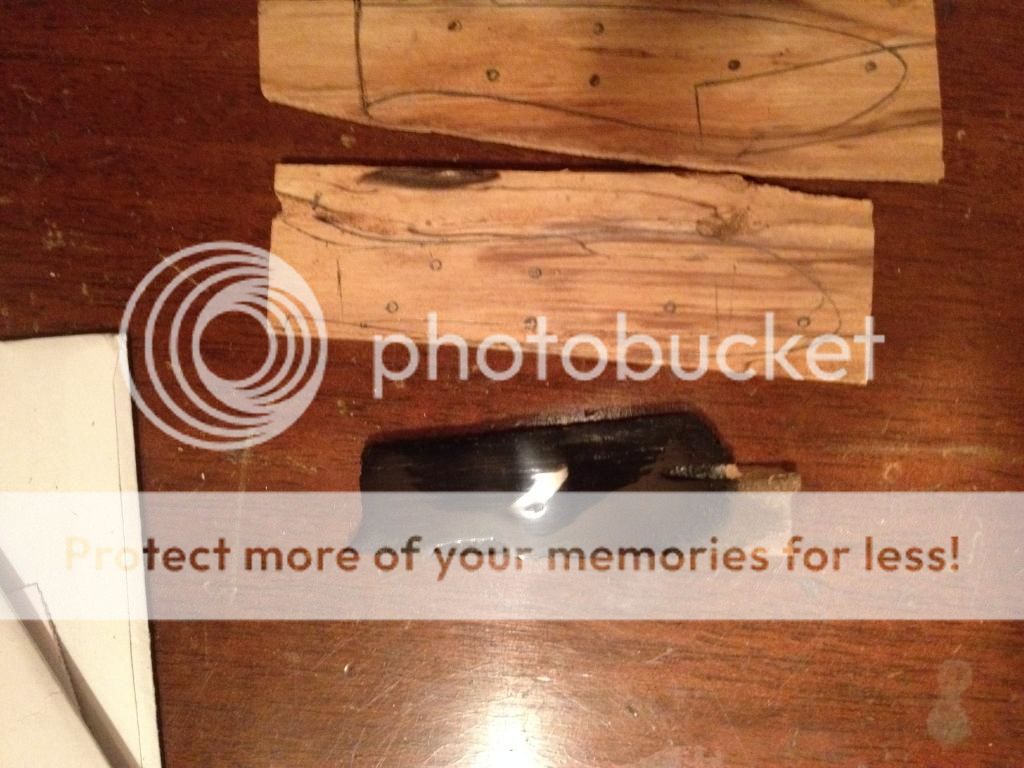

Just thought I'd share this. I bought a knife blank from the auction site for some low cost experimenting. I have been wanting a knife with an ebony handle but the entire point in this knife is low cost. So, I found a piece of mystery wood from an old project and thought "hey, I wonder if my leather dye will work on this wood?" It's the Eco-Flo professional water stain from tandy leather. I've already marked off the parts for my handle and used a scrap piece for the experiment. I squirted some of the dye on a wool dobber and rubbed it in. I let it dry a few minutes and hit it with a hair dryer to speed things along. I did a quick sand job with 320 and 600 grit. Then, three coats of superglue. Another quick sanding with 320, 600 and 1500 to smooth it out some. Finally a few passes on the buffing wheel for a nice shine. I think it turned out pretty good. I'll spend more time on the final project but now that I know it works I'm going to make it happen

Well, a little history lessen for you :). Ebonizing is the process of making one wood look like ebony. It's been used for hundreds of years as a low cost alternative to using real ebony. One way is to use some type of hardwood and apply iron acetate. Basically vinegar with rust in it. It reacts with the tannins in the wood turning it black. I learned how to do this last year while building slingshots. :)
I can see your point on the scales though. However, I've got $12 in the blade blank so the handles would bee worth more than the blade. And, I have the materials sitting on my desk ready to go. It's also handy to know I can use other colors to get a multi colored wood.

It won't take extra hours to do the dying. Maybe an extra 15 minutes. Plus, this is a very low budget project. I will eventually get some ebony because I love the way it feels and finishes but that's a another project for another time. :)
He means it will take extra hours to dye, coat with super glue, and sand then recoat, then sand and polish, etc. vs. with ebony you could cut to shape, sand to desired dimension and polish. He is not wrong.
Okay, let me start over. This isn't going to add hours to my project. 15 to 30 minutes tops. I did the scrap piece last night in 10 minutes start to finish. I've done many projects with a superglue finish and it's not a big deal to do. Plus this is a $12 knife blank I bought. Eventually, if I like how the blade performs, I will buy another down the road and use a nicer wood for the scales. I don't want to put extra money into something if it doesn't work out.
The point of this was just to show that the water stain will dye the wood similar to the old school way of "ebonizing." I hope I don't sound rude, as this is not my intention at all.
