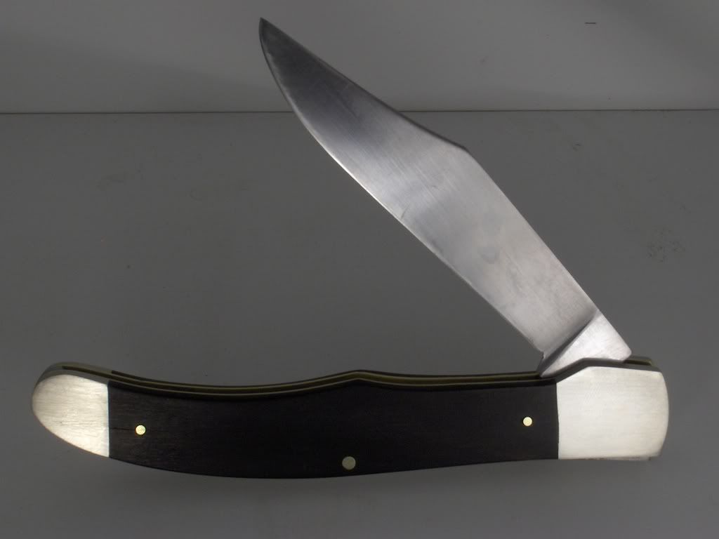

I recently bought a bunch of ebony and have noticed it shrinks bigtime!! I was actually surprised because of it being so hard. Anyone else had this happen? It set for 15 years before it was used and both ends where waxed, I since then have cut 4 different pieces and noticed the others didnt hardly shrink at all, I guess I just got the bad part out of the way first?

Charlie, I bought a large block of ebony from a supplier about a year and a half ago and had the same problem. The wood was supposedly dry and still had the ends waxed. I used it for some scales on a knife for someone in my family and about two months later he called and asked if it's normal for the pins to "grow" :)
There was literally 1/16" of pin showing on each side of the handle. Boy am I glad this one was a family member...
I'm still not sure if I had a "green" piece of ebony, or if his climate was that much drier than mine.

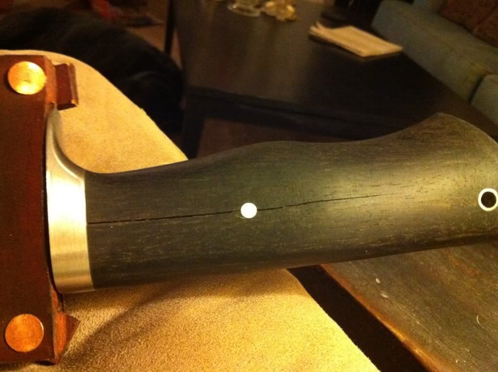

Here's a result in the crack of this Ebony Charlie was using for my knife in question... looks like we'll have to rethink using this stuff. :thumbdn:
Ouch, I have had cracks when I peened the pins too much, just a little and the pressure starts a crack.
Seriously makes me sick to look at it, but safe to say were gonna put some good wood on it. Ebony will never be used in my shop again for anything.

OUCH!!! Very nice looking handle except for that crack!!! :eek: :( :grumpy:

There's no bad wood, just bad tools, techniques and application. That crack is not from shrinking (shrinking means it was used not fully dry), but stress probably from the pin. There's no evidence in the photo the wood has shrunk away from metal anywhere. Everyone works in their particular comfort zones.
This ebony set up for 15 years from what I was told, I dont know? Im sre it was due to the wood shrinking, the pins are never presed in, their holes are drilled to match almost perfectly. Boy do I hate this, first time for everything
