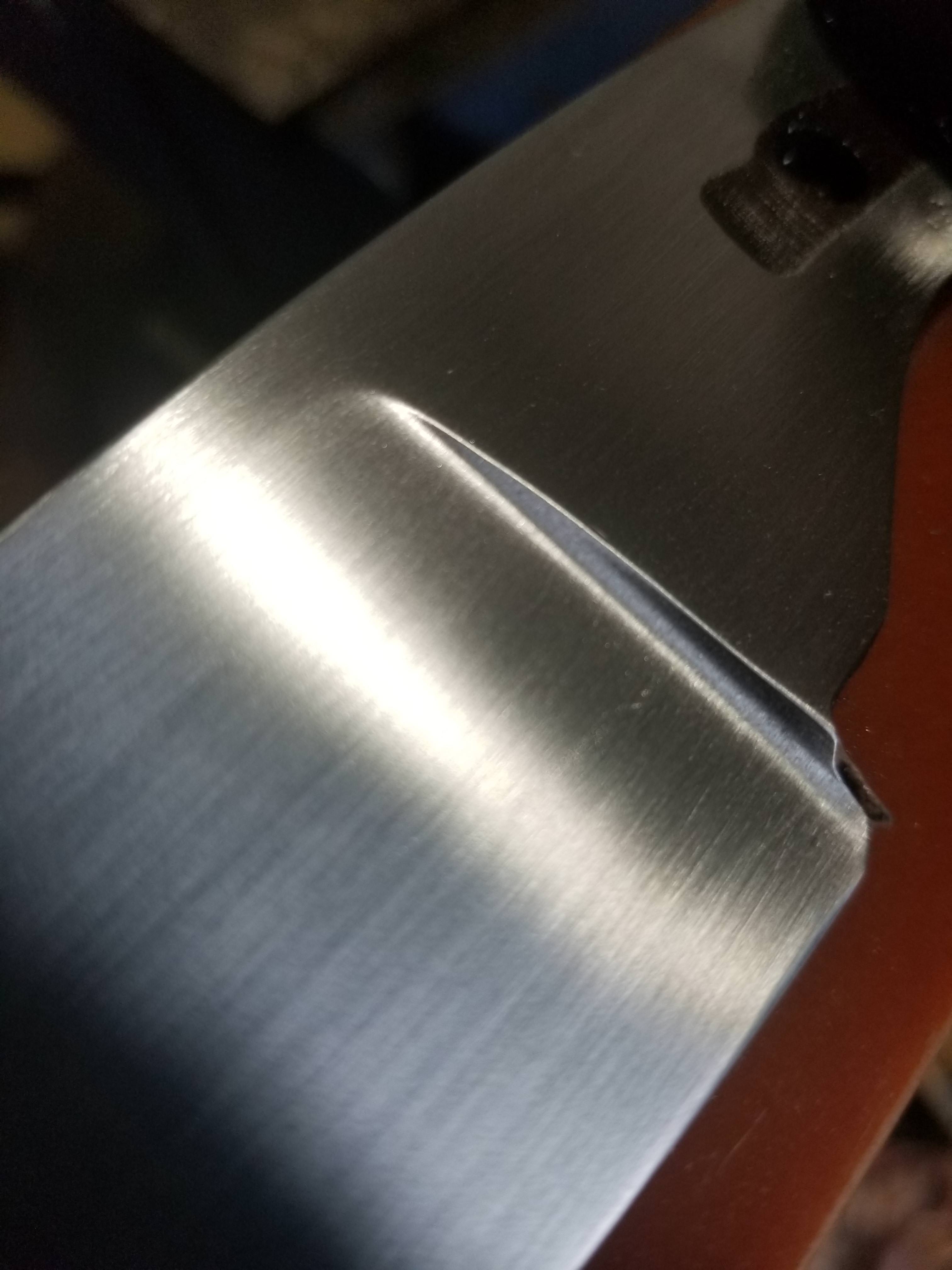

Currently working on a little 2.5" FFG knife and I bit the spine rushing my bevel up to the spine. Decided to take a welding magnet and surface grind some material off, which left me with a funky little flat:
In my research, I came across this tutorial by Ed Caffrey, which piqued my interest. At 4:33 you can see Ed point out his very wavy inconsistent grind line, and simply states that he will just blend it in with hand sanding. Stopping short of the spine seems like it would make grinding FFG knives a lower risk operation, especially when focusing on the plunge lines. I have a hard time visualizing how this technique won't result in some funky reflections when the light hits that area.
Before I run the grinds all the way back up to the spine again, I thought I'd see what the experts here have to say, because I'm thinking about just giving Ed's technique a shot.
I think we all do a little blending when hand sanding, some try to do as little as possible and won't use a soft backer or wrapped paper until the very final grits. Others do more. Don't necessarily think one way or the other is right, but while I've definitely hand sanded things I just couldn't seem to get right on the grinder, these days I try to do as much as humanly possible before hand sanding.
So I would go back to the grinder but by no means does that mean you can't do it how he's showing. I just think it's more work in the long run, because if it's a grinding skill thing that prevents it from coming out how you want, hand sanding from there is just taking away practice.
When I first started on here I remember a guy posting something like "it takes me 1 cup of coffee to hand sand a blade, if it takes you longer you need to go back to the grinder." Don't remember who, but at the time I thought pfff yeah that'll never happen. But while I didn't think that was possible for me, I kinda took it to heart and now, while it still may be a little unrealistic for say, clean 1500 grit hamon prep, it's not entirely unreasonable for a blade sized like yours at 600 grit, coming off the grinder at 400 or better with your lines where you want them.
I agree with kuraki... The better you get it off the grinder the less you have to do by hand. The more you make knives, the less time you have/want to commit to hand sanding. One thing I learned recently is that getting a nice, even, smooth (~400grit) plunge on the grinder is a god send when it comes time to hand sand. Getting deep, 60 grit scratches out of the corner of the plunge is one of the most patience testing things I've done as a maker.
My guess is that Ed's lines might appear 'wavy', but the bevels are probably reasonably flat. You can get wavy lines by accidentally scuffing past your grind line. This isn't a huge issue, but if you have wavy lines because your flats or bevels have major peaks and valleys, then blending it in is not going to be easy, and as you said, very noticeable in a certain viewing angle. Most guys with the resources have a disc sander that they hit the bevels with before hand sanding, and it will generally remove any major peaks or valleys. The main reason the disc works better is because you have a much larger, flat contact area to flatten things out. A 2in belt on a 10in long knife leaves a lot of room for waves to form in the grinds.
I think of hand sanding (especially with 120-320 grit) as a form of blending and truing up flats, more than finish refinement, almost like draw-filing with sand paper.
I do a long of belt grinding at angles or even full vertical. This allows you to get flat on a 2 inch wide belt. I guess this is the primary reason I haven't seen fit to get a disk yet. It works well once you learn the ins and outs, and it won't work on certain blade styles, but likely a disk won't either.
I grind on a lot of belts as well. I also know how to grind vertically... But what do you do when you have a saber grind and forged finish flats with a deep plunge? Not much you can do other than grind perpendicular to the belt. I have a LOT of practice and can get a really flat surface grinding perpendicular... But it would be much easier on a disc, take half the time, and end up with better results. Unfortunately, a disc sander is kind of low on my priority list and I just bought a forge press... So I won't be getting one anytime soon. I just mentioned it because in an environment where the cost of time is high, a disc sander is the direction the pros take. For the newer smiths and makers, the good ol' stick with 100grit paper can flatten things out just as well.

Yeah as far as cleaning up the flats I take the bevel as far up the spine as possible. Then the finish grit should be the same on both riccasso and bevel.
A tip thats saved alit of time is the disc grinder. I use the 6in one from my 2x42. Take it up to whatever finish you want. Just gotta make sure it's a clean consistent finish. Then if you end at say 320 go to your hand sanding station with 320 on a hard backer and get an even scratch pattern. Then do the soft backer straight pulls. So you should only have 2 grits to do.
