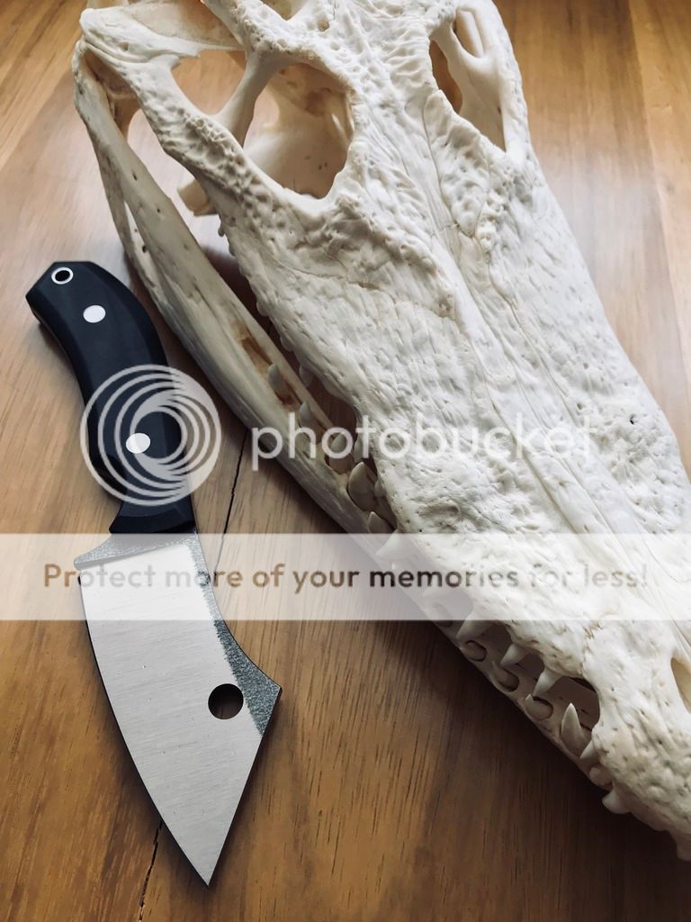

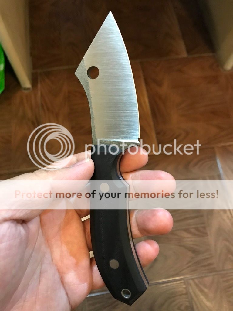

A little cleaver by Wut Ekarach
I design this knife as an all arounder utility blade that would be excel in some kitchen task too.
The edge of this knife is thin and the tip is at the center of the knife so it can stab if need to! the overall functions sre heavily inspire from nessmuk.
The blade is made of D2 with salt pot marquenching and subzero to 61.5 HRC
7.75" Overall
3.25" Blade
1.75" Width
Thanks for looking.
