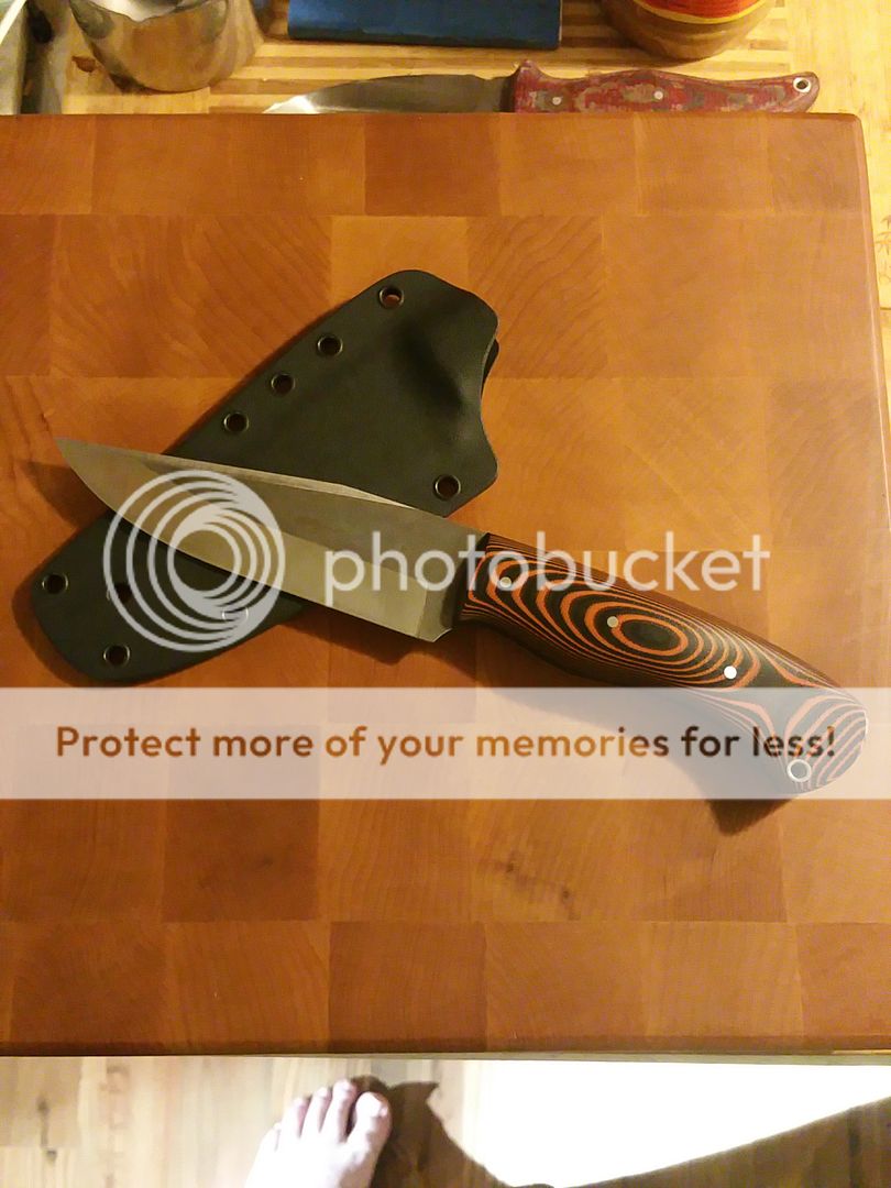

I have managed to get a couple finished and took a few progress pics along the way.
This is a rough WIP of the process I go through. I did just notice I did not take any pictures of or during the finish grinding.
I also do not have any finished pics of the Boner or the M4 knife ( one with the camo micarta ). The M4 one has been on my hip since finished
and it is amazing so far. Once all aspects of the knife was finished and I held it in my hand the knife actually had a bit more of a small fighter
feel and presence rather than EDC. Not saying I do not like the knife I am just going to have to pick a new name for the model.
I am leaning toward "Scrapper", since it has that small fighter feel.
This however does not limit it's function. The handle is still insanely comfortable and the blade-handle angle really puts the cutting
edge in a great position for power and slicing cuts.
I am very excited to get a few of these out into customers hands to play with.

Here are some blades getting wrapped for heat treat
Here I am breaking up my Dry Ice in preparation for my Sub-Zero Slurry
Slurry is ready to accept the blades
A few minutes soak at this temp and the blades are ready for plate quenching
Hardness verified and tempers finished they are ready to have the handles applied.
After the epoxy is cured first step is grind the pins flush and then make the scales even with the tang
Shapes are roughed out and ready for some slack belting to smooth things out a little
Here are the first few ready for some hand finishing to the scales
This is the CPM 10V one completely finished
I have not stopped to take any pics of the M4 knife yet as it has been on my hip since finished. Let me start by
saying that M4 takes a screaming edge. I have not used this steel in a couple years and it is very nice to get reacquainted.
The 10V being so thin makes the knife a bit handle heavy, but that is not an entirely bad thing. The M4 I did not taper the
tang on which I think is a good thing because with the thin M4 I used I think I would have got a similar feel with it. I have
one started in some thicker 3V that I really believe will hit the mark on where this knife needs to be weight and balance wise.
I look forward to a lot of use with these knives through the summer and so on and will keep you updated on my thoughts.

Those look great. What did the blade specs end up at (what you originally described above) ?
The M4 one came out to be 10.1" OAL with a 5.18" Blade
The 10V one ended up 10.18" OAL with a 5.3" Blade
Slightly longer than originally intended, but still very carry friendly.
