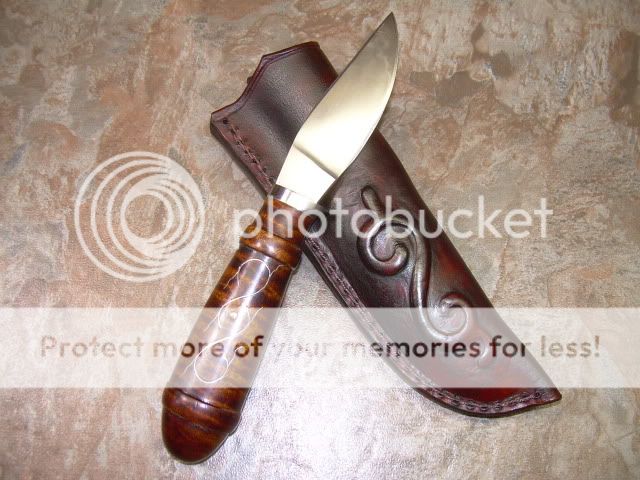

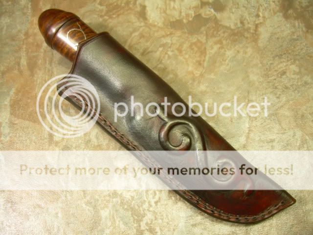

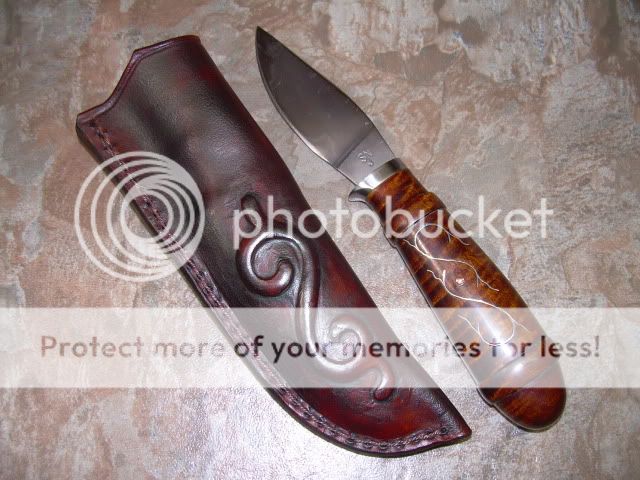

I just finished up this small utility knife, I forged this from a nicholson file with out having a real plan or style in mind. I guess it is a "leaf" shape blade. I clay coated the blade for the quench and it shows a less than perfect temper line.
A 416ss finger guard, stained figured curly maple handle, with Tung oil finish, modest silver wire inlay (my best yet), raised head copper pin and a Moran inspired bass wood lined raised pattern sheath.
The knife is 7 7/8" OAL 3 1/2" blade.

cool man, the wire inlay is very nice and I like how it's echoed in the sheath:thumbup:. Blade profile is rad as well.
