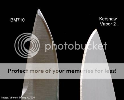

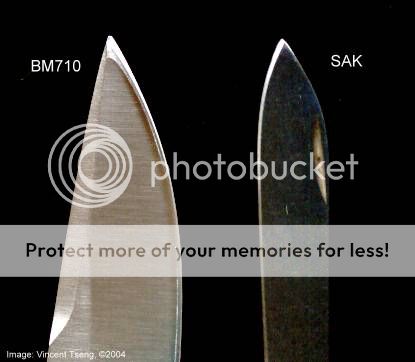

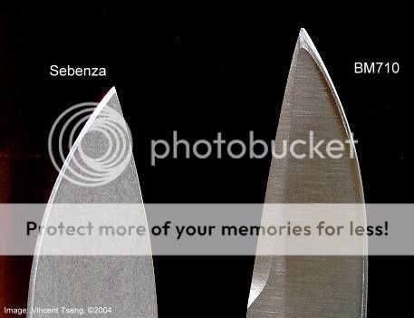

I was always under the impression that the lack (or not enough) of a distal taper - makes the tip thicker - hence sharpens to a more obtuse edge.
I have a Benchmade Axis 710 - that came with a pretty obtuse edge toward the tip - a fairly common complaint. (I recall Joe Talmadge had similar problems from a BM 710)

Pics of the tip of my BM 710 Axis after radical resharpening to semi-convex edge finished with crock-sticks
