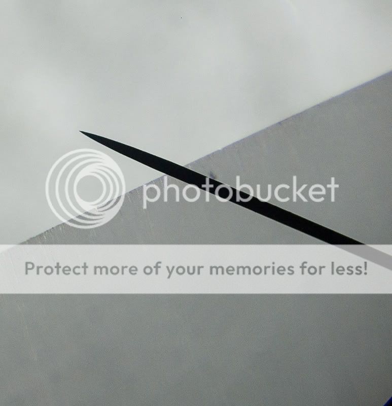

This is something I have messed around with a lot. What I have found is a sharp edge is a sharp edge. It is possible to sharpen a knife with a mirror edge that even under 400x magnification has no micro serrations visible. If you execute this edge well simply touching it will cut into your finger. Forget about running your finger along the edge...
I hear a lot about how a mirror polished edge will not cut a tomato, flesh, cloth etc. I have come to decide people that feel this way have yet to experience a truly sharp mirror polished edge. I feel a lot of the problems that occur with first time mirror polishers is they want the blade to be shiny above all. Little, if any, attention is paid to the actual apex. The apex is the most important. Yes, having a thinner edge with smoothed down shoulders also adds to cutting performance, but sharp really is sharp.
Over the last few years I have posted a lot of videos of seriously scary sharp edges on all types and sizes of knives. I use my knives and I never leave an edge that will not hold up to hard work.
I also hear how an edge with micro serrated apex can not be as sharp as a mirror polish edge. This I am not sure I believe, as my definition of sharpness is how thin the actual apex is, or lack of bluntness of the apex. However you want to look at it.

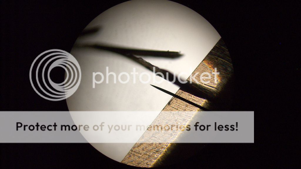

I have shown edges at 400x with micro serrations that will split hairs with great ease:
D2 - 40 micron 3m finishing mesh
I tend to go with a micro serrated edge on my tradtionals and folders. This is not because a mirror polished edge will not cut as well at first, it is because once the mirror polished edge begins to blunt it starts to lose effectiveness quicker than a micro serrated edge in my experience.

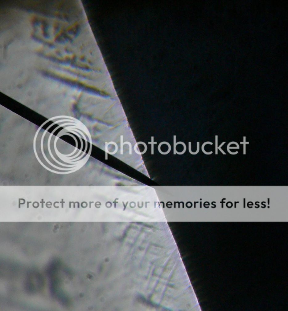

Here is what the edge of my 85 looks like after months of stropping to keep the edge keen:

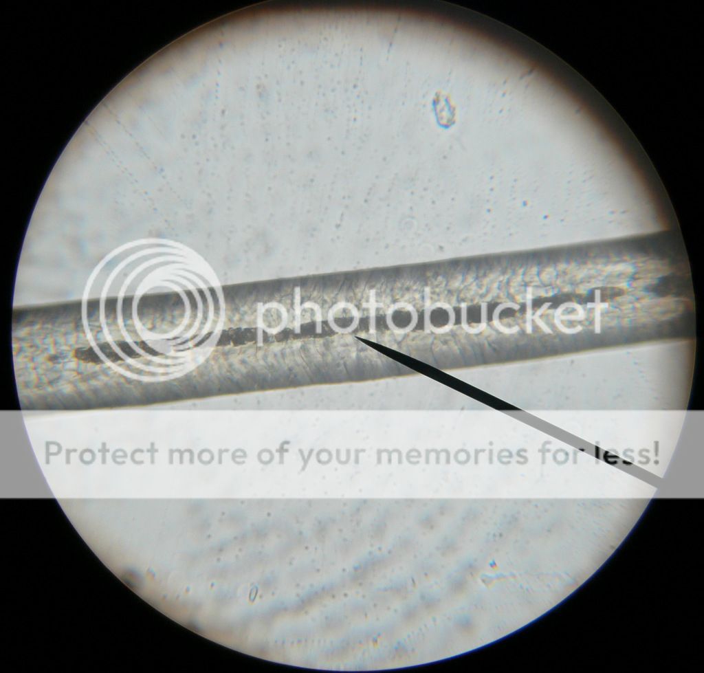

same magnification fine human hair:
Here is what a normal finished edge looks like off my translucent stone:
O1 - ~900 grit
Make no mistakes that edge will push cut and pop hairs like a demon.

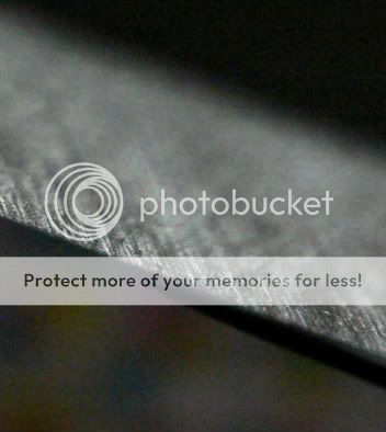

Now here is what a used and up kept mirror edge looks like under magnification:
That edge in person can be described no other way that SCARY.
