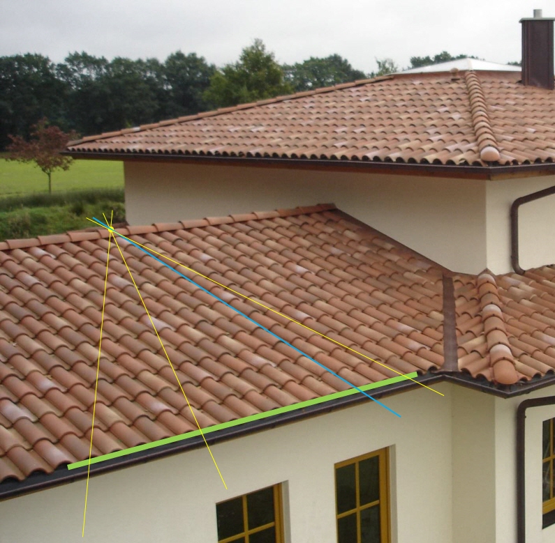

An easier way to visualize the angle of the sharpening arm relative to the blade is to superimpose a roof, like the image below.
As the point of reference, use the case where the "rectangular knife blade" (shown in green) is perpendicular to the sharpening arm (the blue line).
Now pivot the sharpening arm either left or right from that point, along the rectangular blade, relative to this (i.e. the 3 yellow lines), maintaining the same pivot point in all cases.
Note that the yellow and the blue lines are all parallel to the fixed slope of the roof, so the angle is the same in all cases (even though the "radius" changes). You are just pivoting along the same inclined plane represented by the slope of the roof. The angle (of the sharpening arm relative to the blade) would only change if the width of the knife got narrower (e.g. rounding in toward the tip) or wider.
I didn’t understand the roof plane. To keep the same angle increasing or decreasing the radius, shouldn’t you sharpening at 0 degrees?
When you rise (in Wicked Edge you actually spread) the arm to touch the apex you create a geometrical triangle shape between the pivot point, the blade apex and the vertex where is the 3th.
In Wicked Edge we can visualize the 3 point being as pivot the joint ball, the base in which the clamp is mount and the blade apex where the stone touch it.
What I mean is if you put a blade that measure from spine to edge something like 1” and take a measure (from apex to pivot, then put another blade on it measuring 7” from spine to edge you will see the angle difference. Ok, it was a bit exaggerated, but just to illustrate.
Even if you measure the sides lines from green blade until the pivot you will see that the center ones are smaller than the outsides lines that go from the same blade to the same pivot.
If you showed a cross section of the roof for each yellow line it would be clear that the angle does change. As the yellow line from the yellow dot (pivot) to the green line (blade edge) gets longer, you are moving a longer horizontal distance for the same vertical drop, which means a lower angle.
I think I see your point re: cross section. If we think of any of the yellow lines (or the blue line) as the hypotenuse of a right triangle, with vertex P at the pivot point, vertex B at the blade edge intersect point, and vertex A as an imaginary point below the roof which joins vertex P and B in a right angle, we have triangle APB like the crude diagram below (use your imagination to draw the hypotenuse PB).
P
|____________________
A....................B
As you pivot left or right along the green "rectangular blade edge" from the blue line to any of the yellow lines, two sides of the triangle (sides PB and AB) increase in length. But since the height AP stays the same as you pivot, the angle at vertex P has to change, as does the angle at vertex B (even though the angle at vertex A stays constant at 90 degrees). I was imagining a similar triangles argument because the slope of the roof is constant but now that I think about it some more, in light of EconProf's comment, that doesn't work. AP would have to change too, in order for that to work.
Figuring out how much the angle changes...that's a thought exercise. I think you could split it into 2 separate triangle solving problems: a horizontal triangle that you solve first, then take the results from that and reflect it into a vertical triangle. Does that sound right?
It's oversimplified case. The angle at B is not sharpening angle at B. You have to review in 3D and add an extra vertex. Your roof example shows that sharpening angle is the same everywhere, but angle P-B-A is not the same everywhere. In terms of airplanes, the sharpening stone not only pitches but also rolls.
However, the roof is a bad example for knives. It works for straight line cutting edge only. If the blade has a different shape, sharpening angle comes closer to angle P-B-A.
I clamped very big knife (20") with 30 dps in the middle. I got 25 dps in far point.
Of course, it's the weird example. My point is, don't trust anyone who admits the sharpening angle does not change in far point. It's BS.
You’re right,,, this applies only to the straight part of the blade... not when it curves. o_O It does change when a blade curves (and can quite dramatically).

I don't think there is any dispute--including any of the older threads cbw posted links to--that the discussion is only applicable to a straight blade edge. That's the one thing everyone agrees with. But I think there's an additional condition, which is that the straight blade edge has to be perpendicular to the centerline of the sharpener's pivot axis. Correct me if I'm wrong, but if the blade's straight edge is not perpendicular to the pivot axis (i.e. if the blade's edge is skewed) it has the same effect as a tapering or curving blade (or the same effect as increasing/decreasing the width of the blade as in brasileiro's drawing on the right).
cwb: thanks for the old links, but there were a lot of potentially useful photos/drawings that suffer from the Photobucket deletion syndrome.
However, I think the bottom line is that my roof example and explanation was correct (it's essentially showing the same thing as the dental floss examples from the old threads, but using a different visual aid). And my followup regarding non-similar triangles, while mathematically correct, is conflating a different geometric plane that isn't the plane that the sharpening stone face travels over and is therefore not relevant to the sharpening angle question.
The plane of the sharpening stone's face that contacts the blade edge--even though the rectangular stone itself becomes slightly skewed as it is pivoted right or left of the sharpener's pivot centerline--is kept coplaner with the roof plane (assuming the roof plan represents the desired sharpening angle) because the sharpening stone on its rod (for both the WE and the EP) can rotate slightly as you pivot left or right of centerline such that the stone face is always scrubbing co-planer with the roof plane, regardless of its amount of pivot from the centerline.
Do I have this right?
Skewing the blade... if you mean tipping the blade up or down in a clamp... the angle will still stay the same along the straight part. If you think about it, the pivot doesn't see "parallel" or "perpendicular", it just sees "straight" or "curve". (Confusing as heck, but trying to keep it simple). The easiest way to see it is in the Wicked Edge. You can mount a straight edge at an angle, and then just tip the whole Wicked Edge unit until the blade is "parallel" again. (Assuming this is what you mean by skewed). Not saying it will be the same angle if you mount a blade straight then tip it (because you may be raising or lowering the height like in the right diagram shown earlier)... only that whatever the angle is will stay the same along the straight portion. If you by skewing you mean angling it to the left or right as you look down on it (thinking W.E. again), again I'm not sure a pivot would "see" the difference... if that makes sense.
I think the rest you got right.

Started reading but broke off when the whole "the angle changes the further you move from the pivot" thing started again; there is no angle change along the way.
