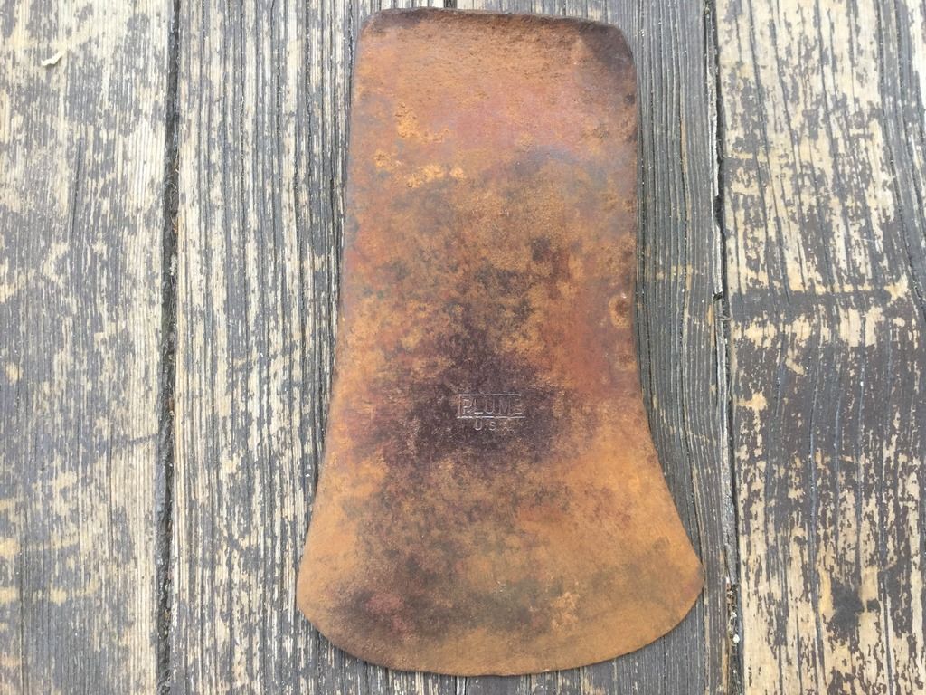

Like this perhaps? I would like to know myself. Is this shape desirable or should it be groud off some. Is this what you were referring Dave. If not, sorry for thread hijack.
@Utican....No actually, the edge on my GB does not look quite like that. I don't have the knowledge to comment on that axe but it does look dangerous to me. I would be afraid to slip or deflect off my target. I mean, with an edge and belly like that, you almost have to hit perfectly square in the middle of the edge every time in order to not deflect off I would think. Someone who knows more will surely chime in.

I have trail crew and some man-powered logging experience... The plumb isn't dangerous, just as long as it has a good sharp edge,it shouldn't deflect. As for the GB, they probably round the corners to prevent chipping. A thin, sharp toe, especially can be prone to chipping and breakage. I don't know how many vintage axes I've restored whose heel and toe have been rounded over time, because they chipped and then were ground down.
