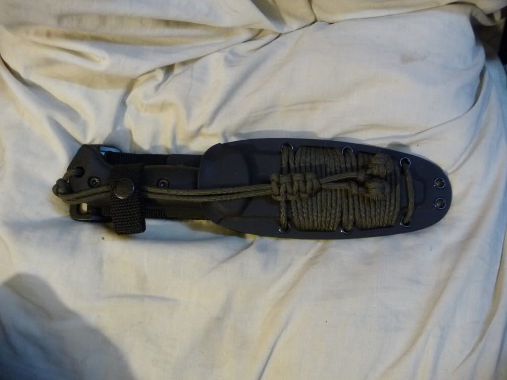

Pics (the lanyard is adjustable and the two balls adds to the masculinity factor :p):
