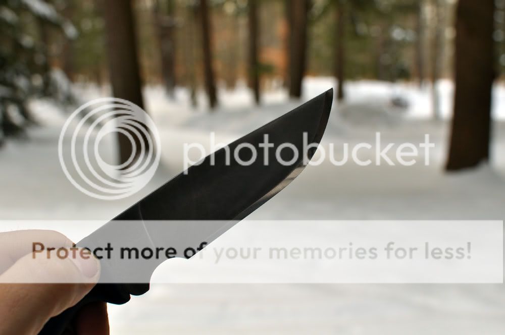

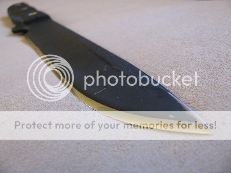

I thin all my Bussekin blades, the bigger ones get convexed, the smaller ones get hit with the DMT plates then stropped with diamond spray up to .25 micron. I just did this one last night, decided not to convex it.
