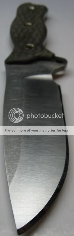

I love convex edges - easy to put on and easy to maintain. With just sandpaper, mousepads and leather I can get ridiculously sharp edges, so I can't justify spending a lot on any other sharpening system.
Here's my game warden with a thinned out, scary sharp convex edge. That double cut also is very resistant to abrasion and looks great even after a lot of use. :cool:
