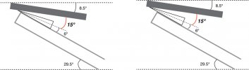

Is there a standard reference most people use for setting Edge Pro angles? I've watched a ton of videos and read a lot of instructions. Most of them seem to be wrong.
The bevel of a blade edge is relative to the center of the blade, not relative to one side of it. On the EP if you measure the table angle you're measuring where one side of the blade is. If you measure the stone resting on the table you assume your blade is at the table edge. This never happens - there's always some overhang.
For a thin blade with very little overhang this is probably negligible. But it's still wrong in terms of how the angle should be measured.
I view my blade as a wedge and measure my angle relative to the center of blade. This takes an extra couple of minutes and may be more work than most people want to do. Is there an easier process I'm missing?

Yes, splitting in half. For a thick blade the difference is a couple of degrees or more. I get that if you're approximating it doesn't really matter provided that it's consistent on both sides.
I'm asking about how to get to a specific angle. It seems that many people trying to how to do this are getting it wrong. Or I'm misunderstanding something.

Got it. Zero on the table, then get the angle of the blade and divide by 2. That works.
Have you watched the EP video on how to do it?
I have watched the video. I don't see how this can possibly be correct. It discounts the blade thickness. For a thin knife it's probably close enough. For a thicker knife it can't be. I can can draw some pictures and post them if you want me to explain why this is.

I place a blade on a flat surface and put an angle cube (zeroed on flat) on the blade to measure the total angle of the primary grind (A).
Then put the blade on the Edge Pro stage and measure the angle of the stone (B).
The edge angle should be 29.5-B-A/2, where 29.5 is the angle of the stage from the flat surface.
No need... I thought about it, and you're right, if you use the degree markings on the EP and followed the video example, there would be a bit of an error. I think if you used an angle cube for step one, you would eliminate the error. But, it might be just as easy or easier to use the idea Diemaker or miso2 suggested.
Good catch! Any idea how big the error is... maybe using the dimensions of a knife you're currently working with?
Excellent! Now that you wrote it down it's obvious! Thanks much. That's a nice, concise formula. I'm doing the same thing but was taking the long way. I don't trust the table to always be at the same angle due to the suction cups so I measure it or us it as the zero angle.
It will depend on blade thickness and distance of the edge overhangs the table. For a thick blade it could be a couple of degrees or more. For a very thin blade it's negligible.

One thing to keep in mind with the "A/2" is that many blades are not symmetrically ground. Some times the flat of the blade stock is on the table and the main grind is then up off the surface.
If the edge is not centered on the spine (knife is ground off center) then got to take it from there. Does that make sense. I'm not sure it makes sense to me. I just know that some grinds are off center in relation to the spine and pivot axis.

All good. Completely agree on the symmetry issue. That's why I starting with "assume a full flat grind" which I also assume is symmetrical. And agree that some factory edges are not great. Just did a Kershaw that was ~18 degrees on one side and may ~21 on the other. Crazy. If the blade itself isn't symmetrical I'd probably just take the knife to a stone. Seems like too much hassle for the EP.

The stage angle may vary depending on the device.
I constantly get 29.5° on my apparatus.
This method only works well for flat ground blades.
May work fine for hollow, but not for convex.
As pointed out above, if the primary grinds are uneven, you will get uneven edge bevels.

Great visual, miso2!! While you were doing that, I was not spending time with my kids and did this to try and explain why the table edge doesn't work to set the angle. Likely full of typos and could use another explanation page or two. Let me know if this doesn't work and I'll try again. Making sense to me and making sense are two different things.

I measure the angle of the stone, when it is set on the blade but not on the table edge.
So, it doesn't matter how much the edge sticks out from the table edge.
I found most knives have 5 - 7 degree primary grind.
So you subtract 3 degree off and can get an approx. edge angle.
