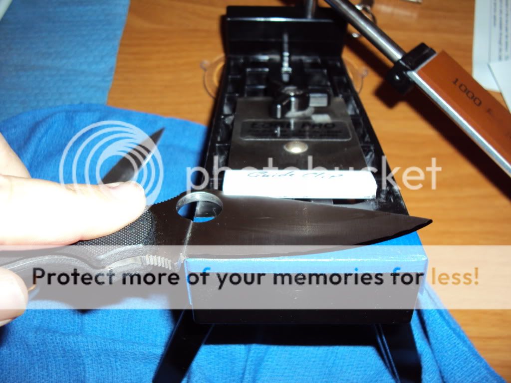

Maybe some of you guys who are more experienced with the edge pro apex can help me out, how do you sharpen knives with a big up swept belly?

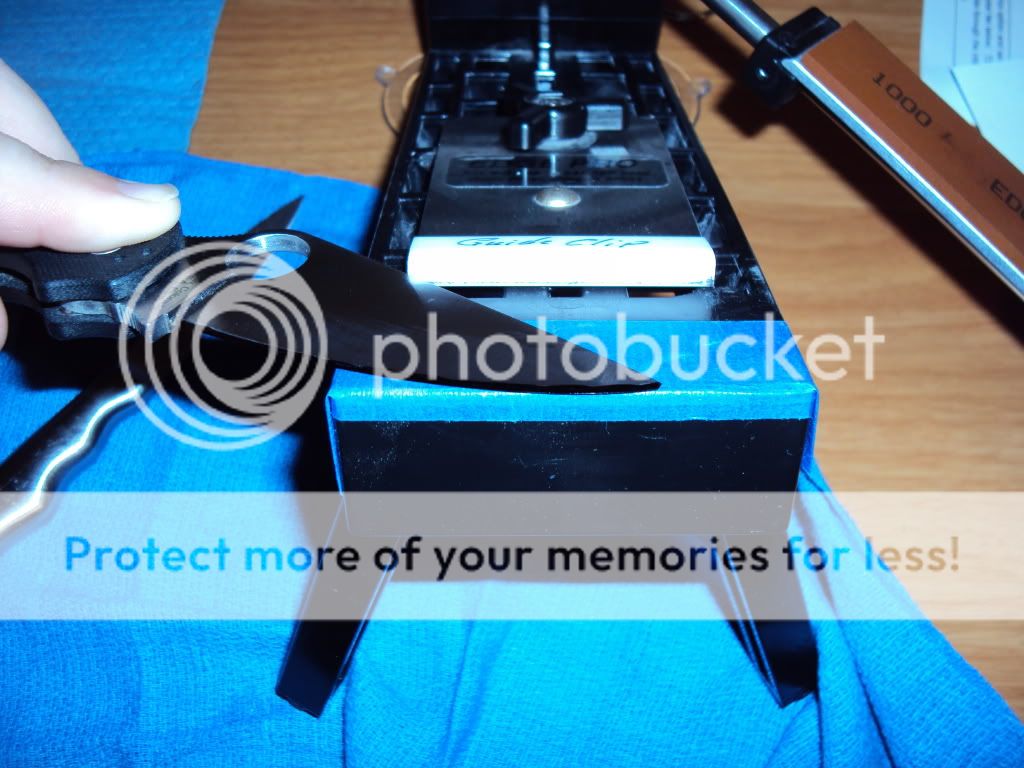

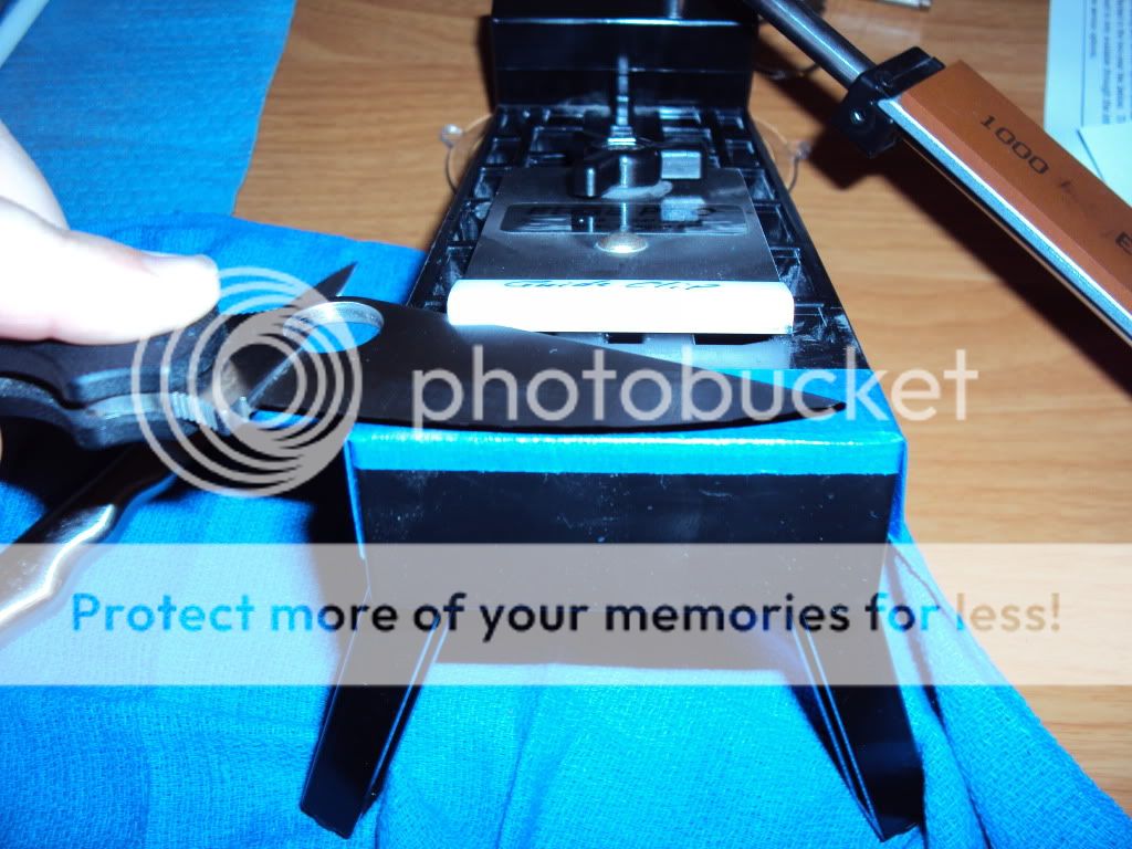

For example I'm trying to sharpen my Paramilitary 2, and the following three pictures will show you how I'm holding it on the edge pro's table and I rotate the knife as I follow through with the stroke in order to get all of the blade
starting position
finishing position

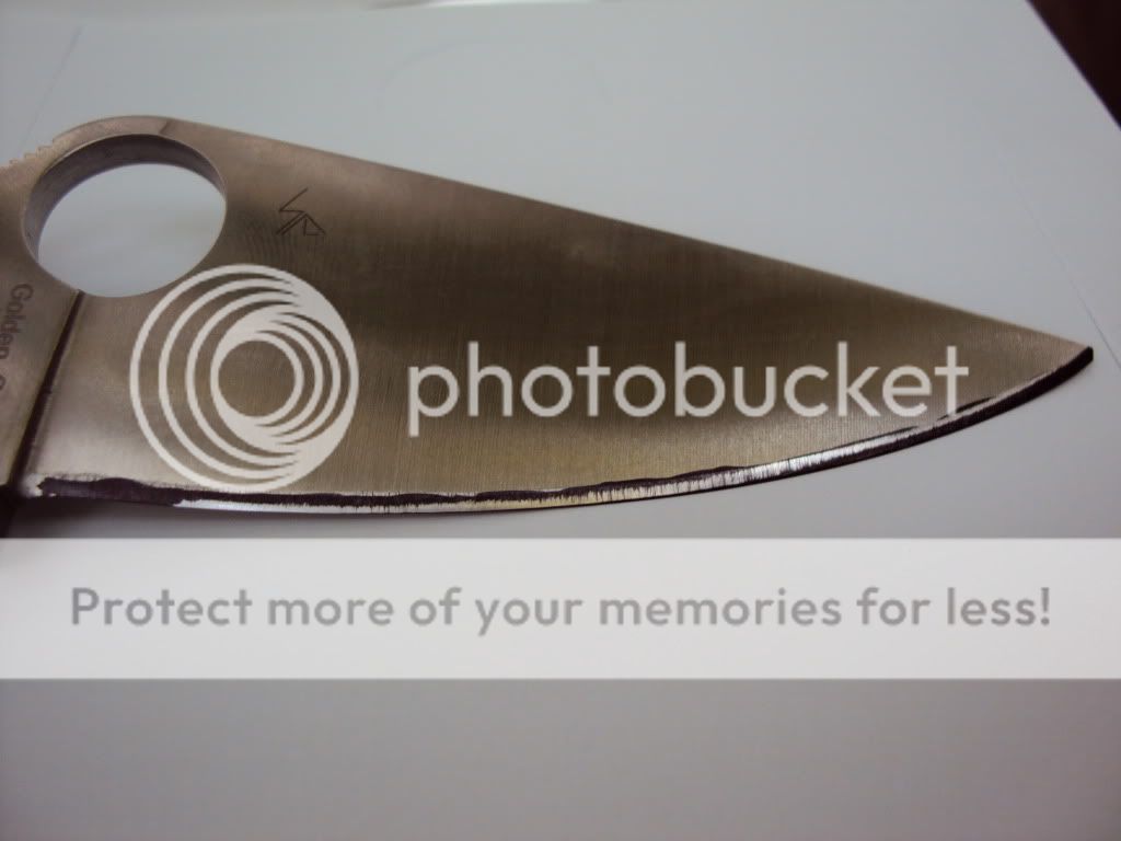

Now you can see from this picture, from the sharpie on the edge, that the stone is only getting the entire edge in one spot, it goes from not hitting the edge at all to hitting the entire edge to hitting just the back bevel.
What am I doing wrong? I've got the angle set at 18 degrees (whatever the green mark is)
Any tips would be appreciated, thanks

It sounds like you are trying to keep the edge of the blade mostly perpendicular to the line of the sharpening stone. I see nothing inherently wrong with that choice but I am guessing that this is your first attempt at sharpening this knife, on the Edge Pro, either since it came from the factory or since whatever other method you may have previously used. What you are doing with the Edge Pro does not match the plane in which the knife was previously sharpened.
With the Paramilitary 2 you have a big flat grind so think of it as a big wedge in geometry terms. You set your sharpening angle at the middle of the blade and in this case you then move the knife keeping the edge relatively perpendicular to the stone. That means that the angle of the stone to the knife edge will be different at each end when compared to the middle. On my JYD II that angle variance would be in the range of .2 to .4 degrees if we go with zero at the blade’s middle. That angle variance is going to vary with the overall angle of the knife grind and to me sounds like enough to do what you are observing.

Angle/shmangle. Pwet's first point is most relavent. Just lay the whole blade on the bed. Bump the plunge line into the side of the EP bed. The tip of the Para will come out almost exactly on the other corner. Adjust the guide up until the base of the plunge line is on one corner, and hold the knife so that the tip is on the other corner. Now...do not move the blade. At all. The angle will be within 0.5 degree along the entire edge. That's more than close enough. You will get perfect results if you can do what is said.
After the advice offered here and a few exchanged emails with Ben Dale I'm pretty sure i've got it figured out. Set the ricasso up on the table and butted the handle scales up to the edge of the table, set the EP at 18 degrees and went at it with the 120 stone until I had an entirely new bevel on both sides.
