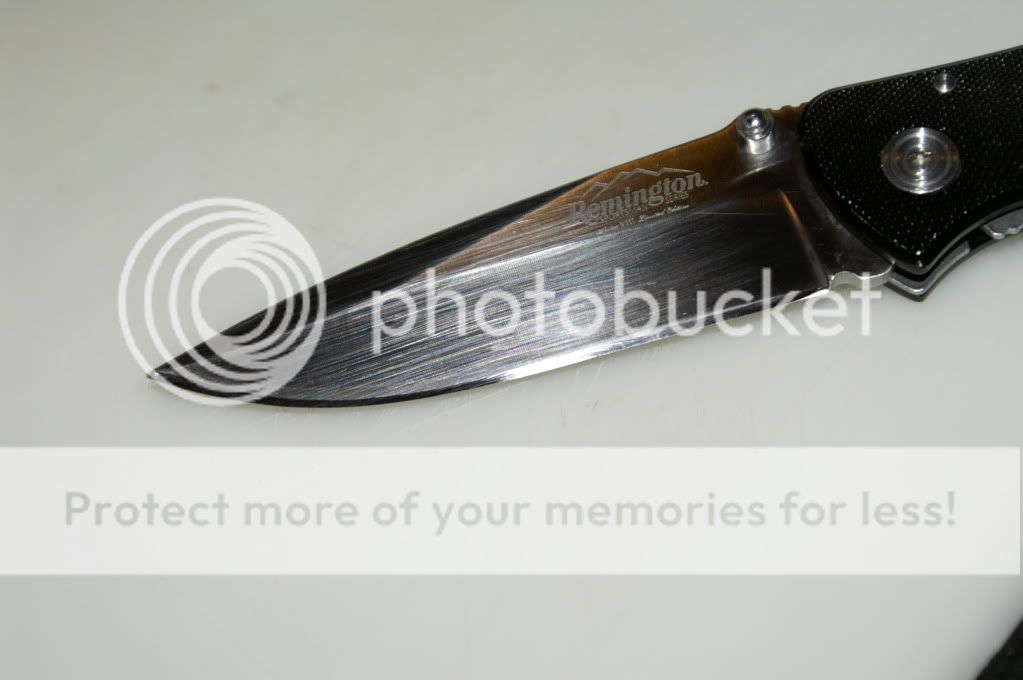

The first knife I "EP'd" was a Remington Sportsman VIII Edition (440C stainless according to Remington's customer service). A Big 5 Sporting Goods knife that I bought for 6.99. I had to reprofile the edges with a whetstone. It was sharp but the bevel was not even. I do get hung up on equal bevels. Heck, my wife complains when I move the furniture back to 90 degree angles when she angles it for a new look.
I set a 19ish deg bevel on the knife with my Gatco setup several weeks ago and the knife was sharp. Arm hair shaving sharp (with some pressure). So that is the history on this knife. When I setup the EP, I did the usual Sharpie test to verify angle. The EP was set to the yellow dot (21 degress iirc) and I went to work with the 600 grit stone. Not much was needed as the knife was in working condition. I changed over to the 1000 grit stone and when I saw the luster come out and shine on the bevel I rushed and jumped to the polishing tapes. The tapes did their job and I had a polished bevel. Do I need one? Not at all, this is strictly something I want. I realized I could have removed a lot more of the wear marks from the bevel if I had taken more time with the 1000 grit stone. This took about 45 minutes. I took the knife and tried to shave my arm. The hairs were literally popping off my arm. For some strange reason I started smiling and felt like a kid in a candy store.

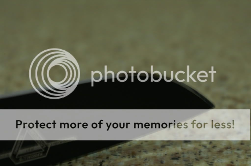

Next knife was my RAT Model 1 (Aus 8 steel). This knife has seen more use than my Remington. I had sharpened this knife with the Gatco with "success". The angle was 19ish on one side but not the other. I have been using this knife with a "working" edge for all my EDC needs. Since I have the EP in hand I went through the following stones (stones were soaking in water):
120 - to recut an 18 degree bevel on one side of the knife.
220 - few passes to slowly remove marks on the bevel
320 - few passes to slowly remove marks on the bevel
600 - more passes to bring out some of the shine
1000 - more passes with lighter touch to start the polishing
2000 tape - polishing
3000 tape - even more polishing

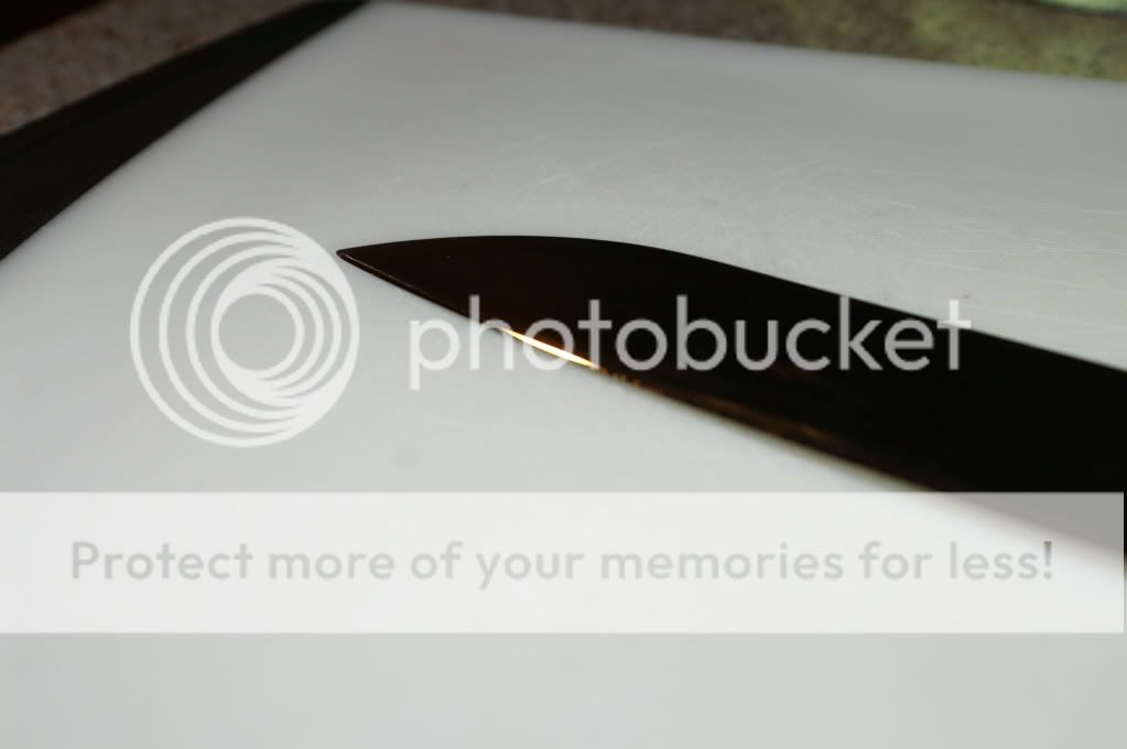

*UPDATE* - A little blurry, but the edge looks cool
*UPDATE*
*UPDATE*

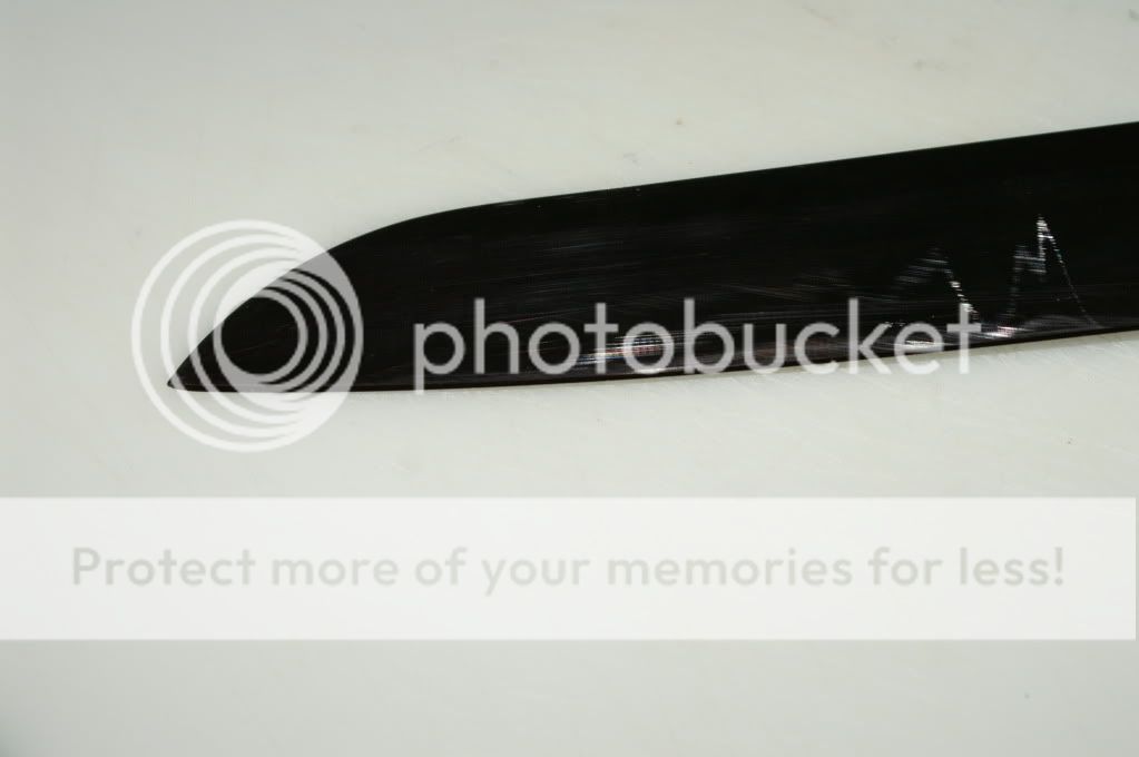

The knife was coming along amazing until....I got some slurry on the tape and it scratched up some of the polish. This was part of the learning curve. I should clean the tapes after a few passes to remove the slurry from previous passes. I did not go back to 1000 and work my way up. I was already very happy with the results.
This knife is now hair popping sharp and has equal bevels on both sides. I am surprised to see some posts on the EP where the user did not have success and returned the unit. I my very short time of using it I had some mishaps but learned how to use the unit. I have watched the videos and the Gatco system has a very similar stone movement, which my have helped.

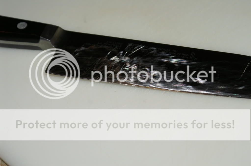

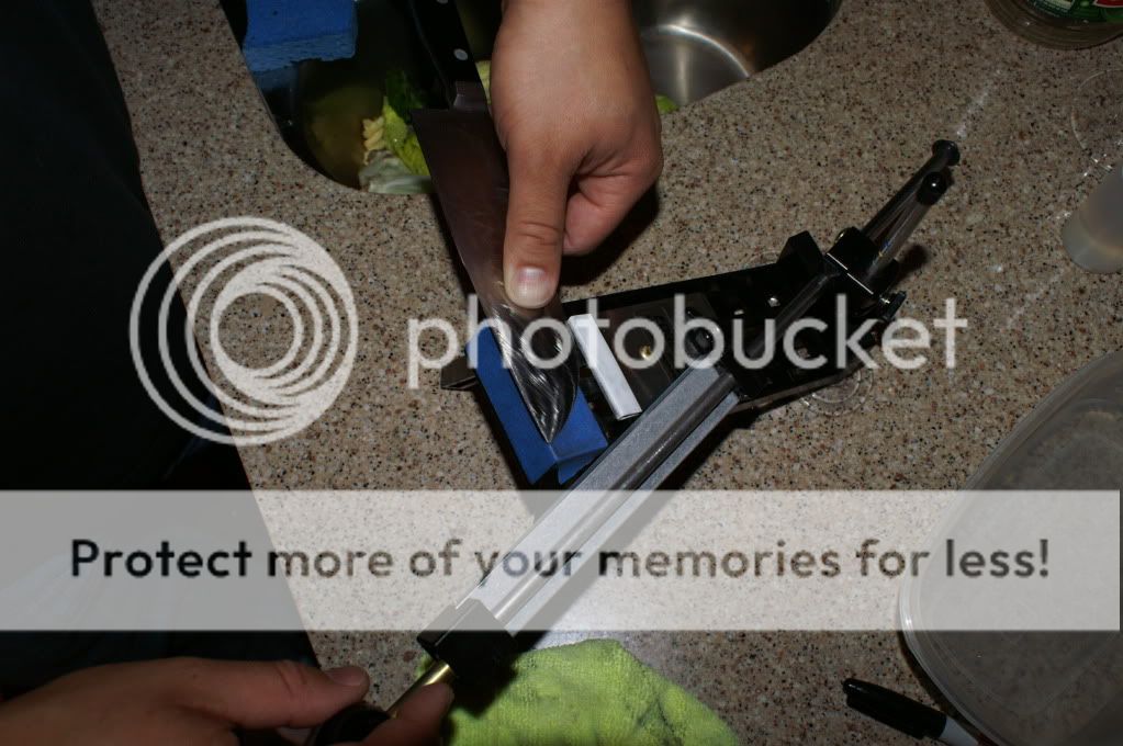

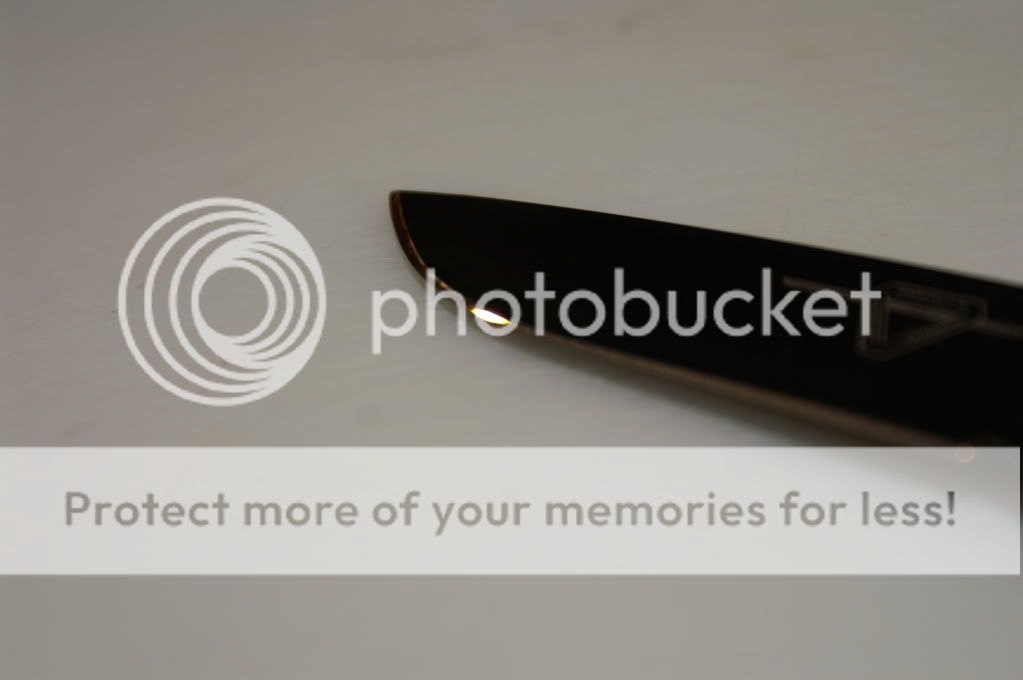

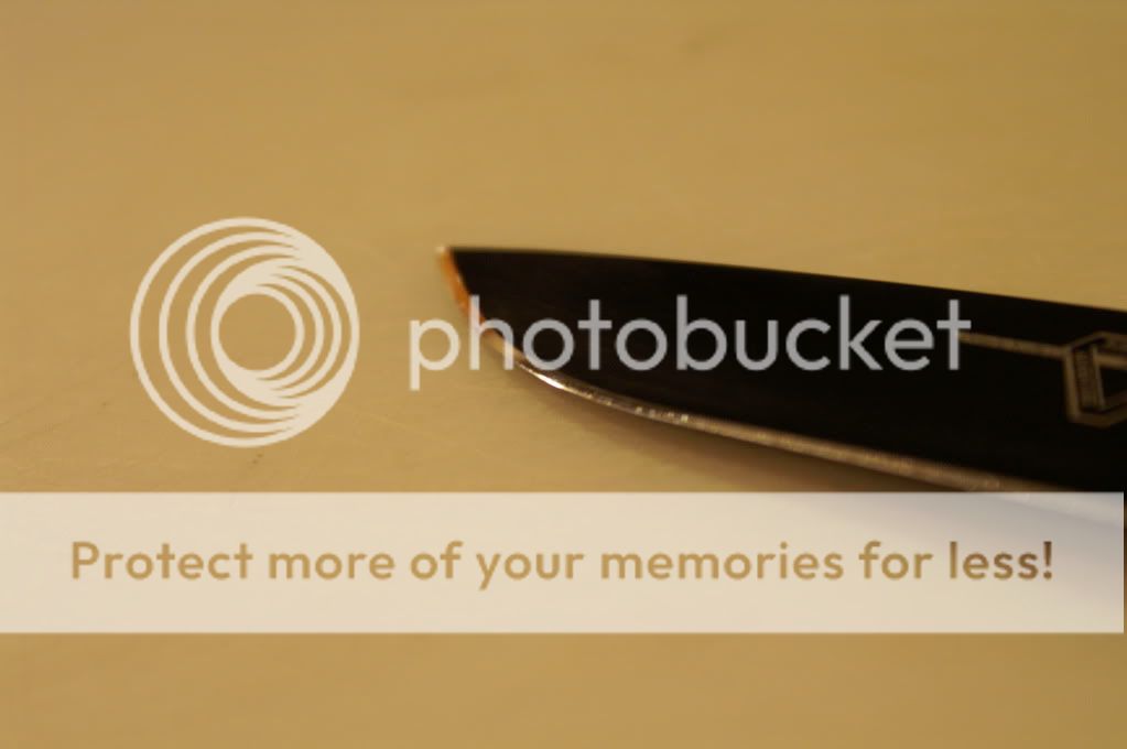

So this evening I used the Edge Pro on one of my favorite kitchen knives. It is an older Henckel Santoku non scalloped. I had sharpened it last with my Gatco and been touching it up with a Henckel steel rod.
When I put the knife on the EP the proper setting was on the red dot (15 degrees). The right side was spot on. When I turned the knife over and checked, it was off. I guess even with my attempts to be precise with the Gatco, it wasn't even. I took the 120 stone and made sure the angle was even. Here are some before pics:
The knife was sharp and worked great for me in this "state". But I wanted that even bevel. The right side of the blade was ready to start with the 600 stone so I went to work on the left side.
I went through all the stones to get to 600.
120 - To recut an 15 degree bevel on one side of the knife.
220 - Few passes to slowly remove marks on the bevel
320 - Few passes to slowly remove marks on the bevel
Once the angles were set, the remaining stones and tapes were used.
600 - More passes to bring out some of the shine
1000 - I spent a lot of time using the this stone.
2000 tape - Polishing. After every section, I cleaned the tape with a microfiber towel and soapy water. I did not want any slurry to scuff up my work again. I sharpened the knife in 3 sections at a time.
3000 tape - Even more polishing and cleaning.
I wasn't really looking for a mirror edge. I just wanted an even bevel and a pretty edge. I realized that grip is key for a larger kitchen knife. The videos on EP's website show Ben Dale hold the knife from the handle and go to work on the blade. I tried this only once. I realized that I was not keeping the blade completely flat. So my solution was to choke up on the blade.
This gave me all the control I needed and I was able to work the blade with the EP.

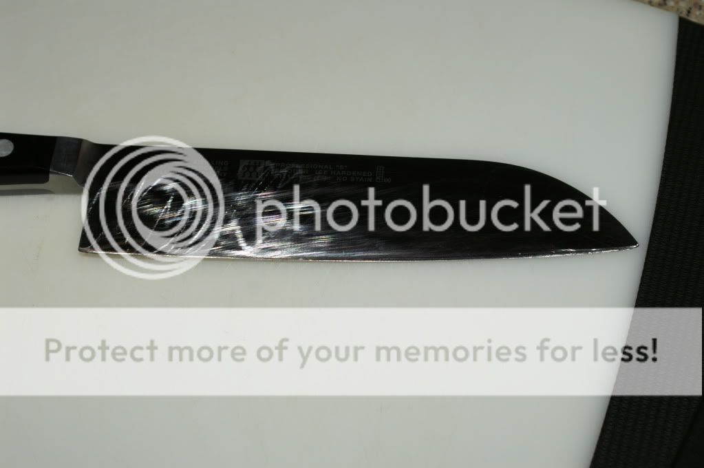

Here are some "after" shots:

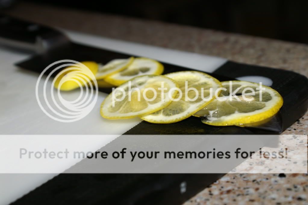

Some cutting was done as well. I did not have any tomatoes in the refrigerator so I used some lemons.
I saw someone on Youtube do a "drop" test on their kitchen knife that was sharpened on a whetstone. They dropped a tomato onto the blade from about 5-6" up. I used a lemon. I wasn't sure if it would bounce off or cut.
It cut.
