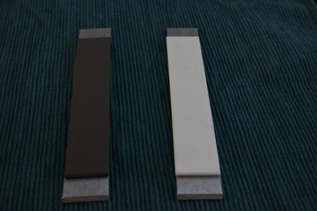

Just wondering if any one has tried this? I got the medium and fine 1X5 in Spyderco flat stones. I'm gonna glue the to Edge Pro blanks as soon as they come in on order now should be here by Wend. Has anyone given this a try? I was thinking it would be good for a quick touch up, same as the Sharpmaker but any angle. Let me know what you think. Will post back when all set up.

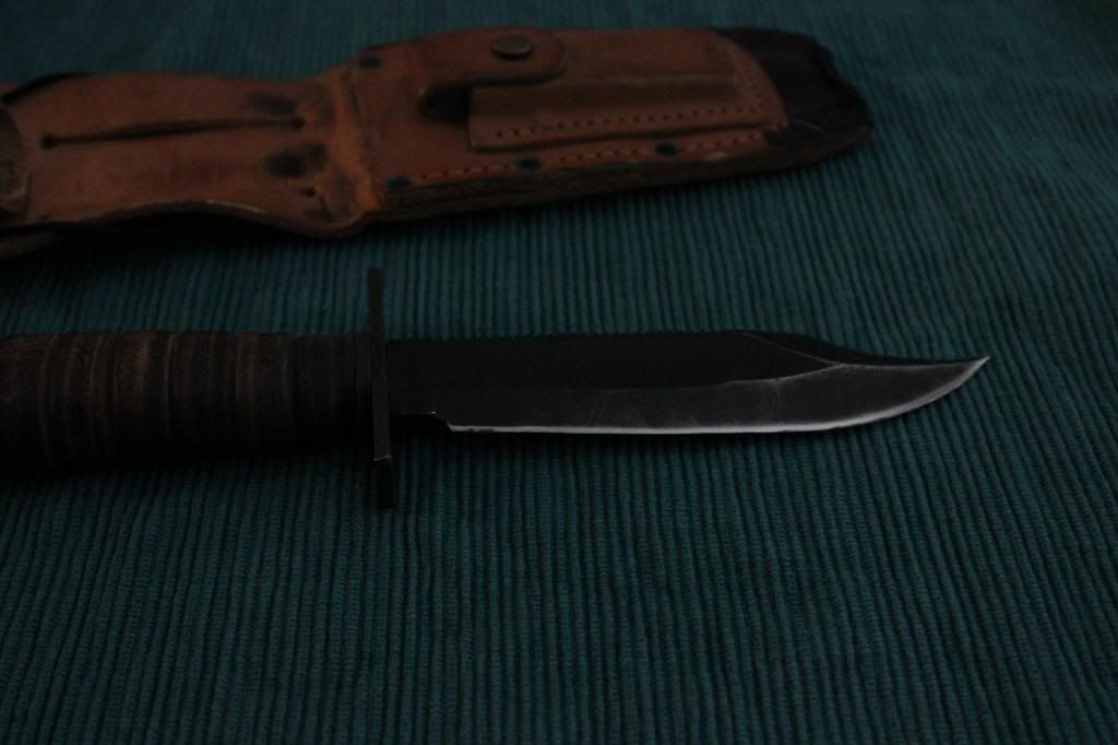

I have the Spyderco stones set up. I used a POS beater knife with a messed up edge to try them out and break in the stones.

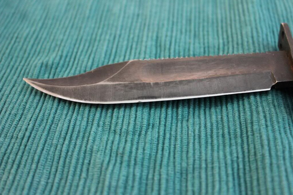

After some work.[/SIZE]

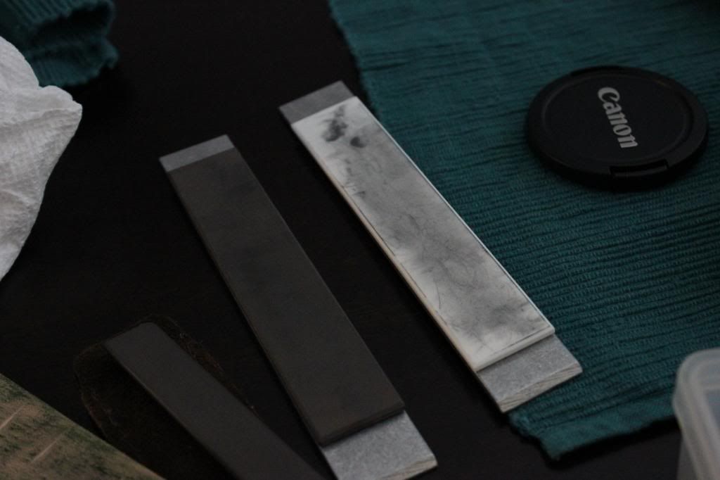

Turned out to work well. The stones kinda clog up quick. But for touching up an edge it will work great.
One of the great things about the EP. You get to experiment.
Did you use them wet or dry?
Grab some Bar Keepers Friend for when they really clog. Truly great (and cheap!) stuff for ceramics.
I have been using Bar Keepers Friend to clean my Sharpmaker stones for a long time. I did clean them when done with this since they were so gummed up. But for a touch up I wouldn't clean them unless doing more than a few knives.
