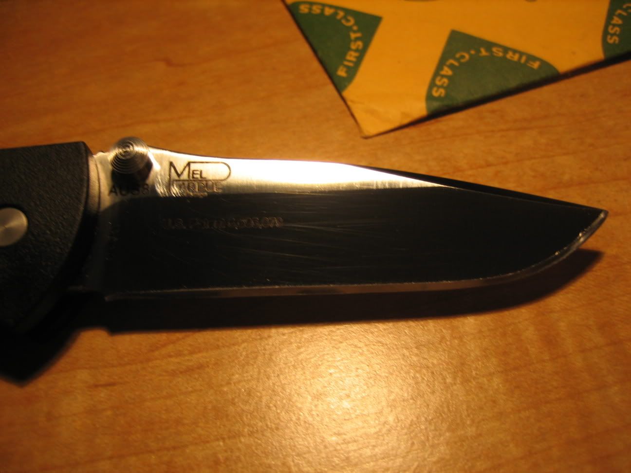

I just looked at a web pic of the mini-ambush. I notice there is a flat grind in a narrow strip near the spine, then a concave grind for most of the width of the blade. Is it possible that in avoiding the thumbstud, the flat grind lies flat to the corian bed in one orientation, while the concave grind lies flat to the corian bed in the other?
Its just the primary grind differences that cause that and nothing more. All it means is that the grinder took one side down a bit more and didn't go as far on the other. Its common for everyone to have a strong side and a weak side so sometimes to the experienced eye you can tell from looking if the knife was ground free hand, if the maker is right or left handed or get a pretty good guess in as to the maker's stronger side anyway. ;)

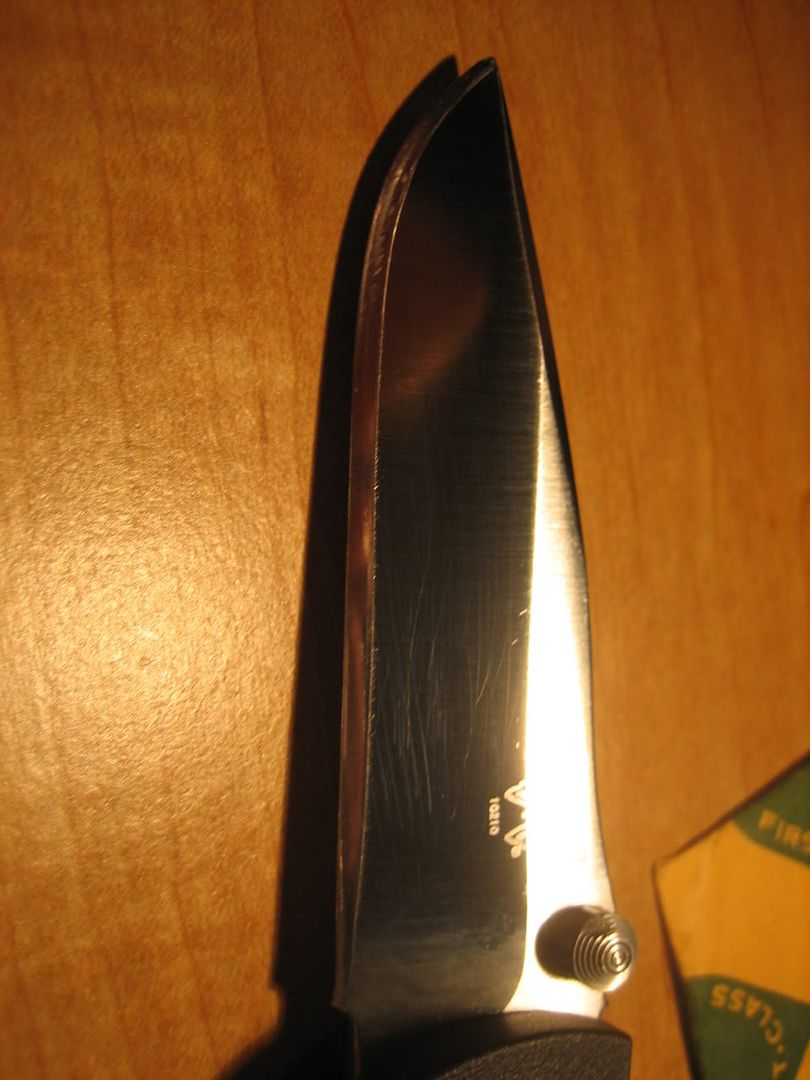

Both sides are 15` or 18` if that is what you used but the thicker the blade is the more profound the bevel will appear for how high it comes up on the blade. If its a thin grind it can still be 15` but appear as if its a very small bevel angle. Its still 15`. I hope that makes sense. Anyway, just some thoughts on it. I have to run. The wife has put me to work.

Here is how the edge looks:
Do you think they are both the same angle STR?
Also note how I accidentally messed up the thumbstuds... Very unhappy about that...
